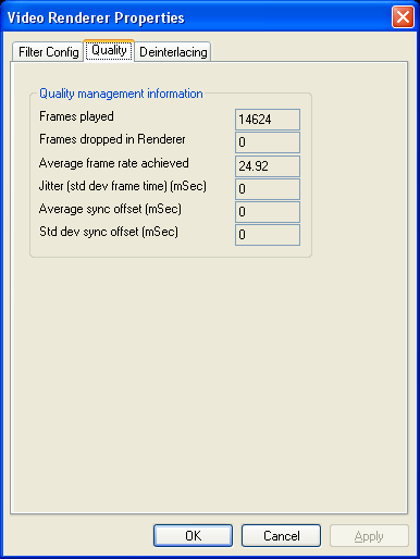

- picture start showing normally for a couple of minutes
- after that jitter begins
- average frame rate drops from 25 to around 23 with 10-15 ms jitter showing on renderer property page
- sometimes DVBV filter makes a drop showing Graph too late and after that there is a jitterfree period
- sometimes jitterfree watching can last for a long time
- sometimes jitter will not stop at all

Canal+ HD works perfectly with 15,1 Mbit/s bitrate:
Anixe HD is having jitter with any bitrate (5-20 MBit/s):
