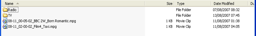

smilingcrow Posted August 13, 2007 Author Posted August 13, 2007 I'm adding an image showing the time at which the failed recordings took place in case the time information is needed when looking at the log files. Quote
