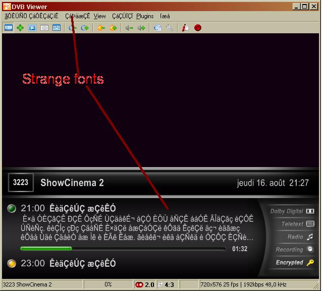

mouadhada Posted August 16, 2007 Author Posted August 16, 2007 The question was about the Language file you have selected in DVBViewer. Open the used file with notepad ....\DVBViewer\Language\Arabic.lng. [Font] Charset=178 [Actions] .......... The charset is 178, but in gui I have not arabic but some strange fonts fonts. I join screen print Quote

Griga Posted August 21, 2007 Posted August 21, 2007 I can not see GUI correctly. Sorry, I didn't notice the screenshot at first. Obviously the GUI doesn't switch to the character set that is specified in the language file, but still uses a French resp. western character set (?), as far as I can see. Is French your "system local" setting? Strange enough, I'm struggling with a similar problem here. I can set the app I'm looking after (DVBViewer GE) to whatever character set I want (in program code!) - it insists in using the system local character set. And when I set the character set in the DVBViewer Pro German language file to Arabic or Hebrew, it has no effect at all. However, displaying other character sets seems to work in general, because in the videotext language selection menu they show up as expected. So I will do some more investigations in this issue, and when there are results, I will let you know. Anyway, thank you for the XML file. Unfortunately the EPG data doesn't specify the character set, only the language: <Descriptor HValue="0x4D" Name="Short Event"> <Language String="ara"/> <EventName String=" ÇäÌÒêÑÉ ÇäÑêÇÖêÉ + 2 "/> <EventDescription String=" "/> so it will probably be hard to find out which kind of character table is required. Following the DVB specifications, a default latin character set must be used in this case, which obviously wouldn't match. A character table description included in the EPG data looks like this (from a Polish channel on Hotbird): <Hot_Bird_13.0_E_10891_H> <Descriptor HValue="0x4D" Name="Short Event"> <Language String="pol"/> <CharacterTable HValue="0x01" Name="Latin/Cyrillic"/> <EventName String="i -> Lista ProgramÂow"/> Quote

Griga Posted August 22, 2007 Posted August 22, 2007 Ok, the results of my investigations: - DVBViewer can only be used with a certain language file, if it matches the system local setting - French in your case. - The Charset entry in the language file is meaningless I tried to let DVBViewer GE display the UI with a different character set, and finally it did - partly. The main obstacle are standard controls like buttons, checkboxes and some more, that don't support displaying a different character set. They always use system local, no matter what I tell them. This could be solved by using more sophisticated third-party components, that are able to display other character sets, or even Unicode. However, this would require restructuring many parts of the program, altogether a whole lot of work, and to be true, I don't believe that this will happen. DVBViewer is just a 15 Euro software, DVBViewer.com is no big international company, and most people who are working at it don't get payed for it - they do it voluntarily (like me). One of these internet communities, you know... I have a golden interstar 7800 receiver and I can see epg info correctly on it. Usually companies buy a licence for a character set ROM from some other company, connect it to their electronics, and that's it... sorry, we can't afford something like that. However, if there is a chance to enhance the support for other languages, be sure that we will try (within our limits), if we get some help from the users. At least displaying an Arabic EPG with an Arabic character set should work somehow, even if system local is French. I will keep an eye on it. Quote
