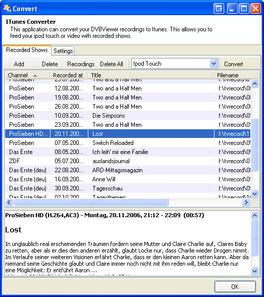

hackbart Posted October 14, 2007 Posted October 14, 2007 And i dislike the idea to encode commercials in order to cut it afterwards in the reencoded video. The result is lousy and even if a simple realtime encoder can be easily done (Just try to do something like the following command script): mencoder http://yourip:yourport -cache 1024 -o recording.flv -ovc lavc -oac mp3lame -of lavf -lavcopts vcodec=flv:vmax_b_frames=0:vbitrate=500:turbo -aspect 16:9 -vf pp=flb,scale=544:576 -srate 44100 -lameopts mode=3:cbr=64:aq=1 -lavfopts i_certify_that_my_video_stream_does_not_use_b_frames we dislike to integrate this inside the DVBViewer. If you really want to encode the live stream use mencoder or ffmpeg instead of nagging for such a feature. The usage of both tools is damn simple. Before asking where to find these tools try to use google, yahoo, msn (or whatever). Christian PS: I really started to like ffmpeg and i hopefully will be able to publish a small tool i made for my brand new ipod soon: Quote
