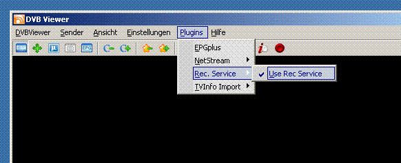

the service is a real windows service (if you don't know what that means, have a look here). It's controlled with the recording service control plugin for DVBViewer which should be in the package. Just copy the svcctrl.dll into the DVBViewer plugins folder (if it isn't there already) and you'll see an entry in DVBViewer plugins menu. Just enable "use recording service" there. The service and DVBViewer shouldn't run at the same time. That's what the plugin is for. So when DVBViewer is running, the icon should turn grey, if DVBViewer closes the icon should turn orange.

There was svcctrl.dll-file in the Plugins-folder. Still I can't find anywhere Plugins-menuitem.
I also deleted that file (=plugins folder was empty), restart the DVBV and copied it back, no change. Still I can't find anywhere Plugins-menuitem.
Where it should be?
It should look like that.
Yep, no such menuitem here. I don't understand those menus (I'm finnish) but anyway it should be between Help (I think) and "something" :bye:
Any idea what I should do?
Problem solved.
I removed all; drivers, plugins, DVBViewer, everything and I installed all back. Now I have rec service working fine.
One problem occurred: Old recordings disappeared from the OSD and "update database" doesn't help. Those files aren't deleted. Weird...
