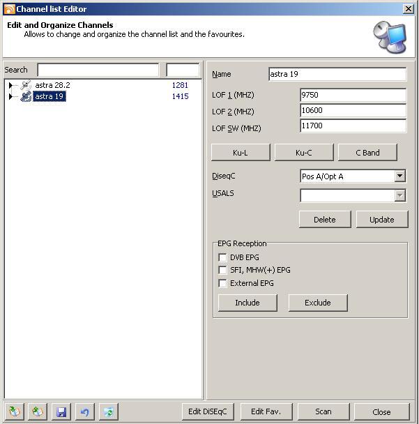

I bought a diseqc switch. The diseqc switch has 2 inputs and one output. I would like to watch Astra 19 on the first input and Eurobird 28.2 on the second input. How should I set up DVBViewer?

..most likely A/A corresponds to the 1st input and B/A to the 2nd.
Okay, I did that, but it doesn't work well. I can watch Astra 19. If I switch over to Eurobird I can't see any picture. I switched off the computer and switched it on. Then I started DVBViewer again and I could watch BBC on Astra/Eurobird 28.2. After switching over to Astra 19 and back to Astra/Eurobird 28.2 I always have no picture. What is wrong?

dunno, just play with the diseqc settings..
I tried all settings, my attempts were without success. Maybe it is a bug. Have anybody an idea?

What is the Diseqc level of your switch, maybe it is 1.1 or 2.0, try an switch Diseqc 1.0 it work well for 2 or 4 input.
You can also try to set retune after missing stream after 1 or 2 seconde.
I am using one for Hotbird, Astra 19.2, Astra 23.5 and Astra 28.2 without problem using DVBViewer and my TF6000pvr, but it doesnt work using ProgDVB. Port 1 is assigned to A/A, 2 to A/B, 3 to B/A and 4 to B/B.
