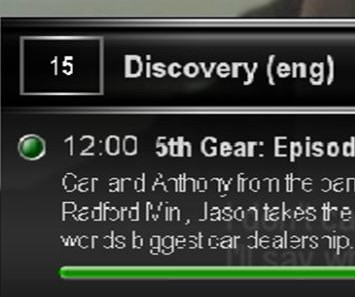

CiNcH Posted December 2, 2007 Posted December 2, 2007 (edited) Dunno, may be a nVIDIA driver bug. It always had problems with YUV formats (OSD format is AYUV in case of EVR). But it was mainly related to the DXVA deinterlacer. However, this problem is also apparent in pure software mode... (also pin 2 is most likely not deinterlaced) Edited December 2, 2007 by CiNcH Quote

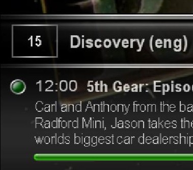

ricabullah Posted December 2, 2007 Author Posted December 2, 2007 I think one friend with Ati will post a SS? Quote
mummum69 Posted December 2, 2007 Posted December 2, 2007 I think one friend with Ati will post a SS? Hi, Here the SS for OSD in, 2600 xt, with EVR, corped, and full one Quote
CiNcH Posted December 2, 2007 Posted December 2, 2007 Great, I am really pissed off by all these renderer driver bugs. Quote
CiNcH Posted December 2, 2007 Posted December 2, 2007 (edited) Ok, may not even be a bug, your resolution is 1024 x 768 means that the skin exactly fits the display resolution and no scaling has to be performed in mummum69's case. But I am not sure... Edited December 2, 2007 by CiNcH Quote

mummum69 Posted December 2, 2007 Posted December 2, 2007 mummum69,Thx for quick respond! ricabullah, not at all. CiNcH, SS without scaling: Quote
CiNcH Posted December 2, 2007 Posted December 2, 2007 I see, with other words, blame nVIDIA... again *g* Quote
ricabullah Posted December 2, 2007 Author Posted December 2, 2007 I see, with other words, blame nVIDIA... again *g* Remember "nVIDIA VMR fix" It was a nVIDIA bug as well, not Ati bug; since there was no AVIVO thing at that time. Quote
Lars_MQ Posted December 2, 2007 Posted December 2, 2007 Some remarks: EVR and DXVA2 drivers must support AYUV. All pins <>1 must be progressive. This is per specs by MS. The Viewer is playing by the book on this. The OSD is always rendered in original size of the skin, no matter how big or small the window is. All scaling is done by the renderer (in hw acc. mode means by hardware). Everything is the same like VMRx modes, except the (lossless) colorfomat conversion. Quote
CiNcH Posted December 2, 2007 Posted December 2, 2007 That's what I thought. What is interesting to me is that OSD looks good on HD channels. Thought that OSD was scaled to the screen resolution, no matter what the video source is like. Quote
Lars_MQ Posted December 2, 2007 Posted December 2, 2007 Maybe we missunderstood: original size= size of the OSD (means a 720 x 576 is always 720 x 576 internally without any scaling by the viewer). The OSD-Filter gets the original sized OSD and sends it after a color conversion to renderer (well it's a little more complicated internally but that's the basic principle ). Quote
CiNcH Posted December 2, 2007 Posted December 2, 2007 (edited) Of course I know that the DVBViewer does no scaling, renderer resp. graphics hardware does and that's where the problem occurs. I am aware of the fact that the problem is not DVBViewer related... From a renderer point of view there seems to be a dependency between video source and OSD resolutions (at least with nVIDIA). Otherwise behaviour would not be different for SD and HD video material. Edited December 2, 2007 by CiNcH Quote

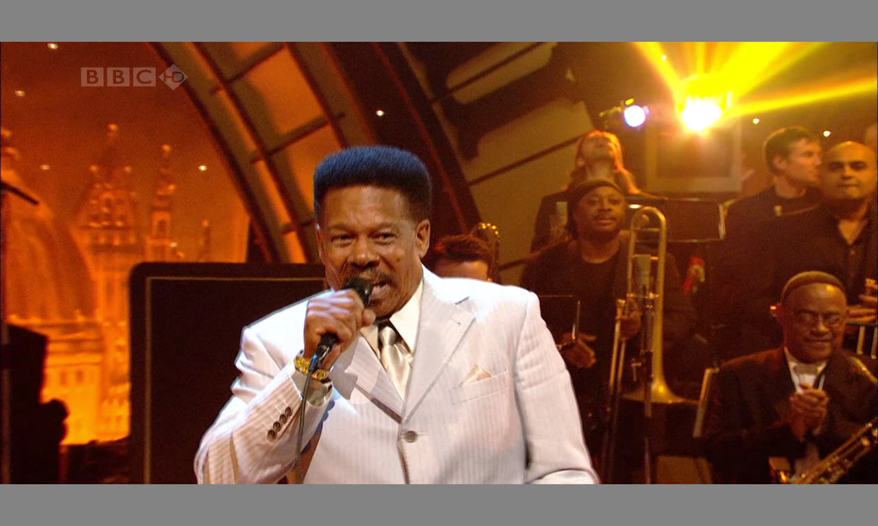

arfster Posted December 15, 2007 Posted December 15, 2007 (edited) Missed this new version, just installed it right now, and perfection with EVR: (click thumnbail to see fullscreen) CPU use barely noticeable at 0.36% (2.4ghz core2duo), vector-adaptive deinterlacing working, no skips/framedrops. That's BBC HD btw, 16mbit 1080i50 h264. My setup: Vista32, ATI 2600xt, 7.7 drivers, latest PDVD codec. Levels are expanded, since it's on a PC monitor. Edited December 15, 2007 by arfster Quote
