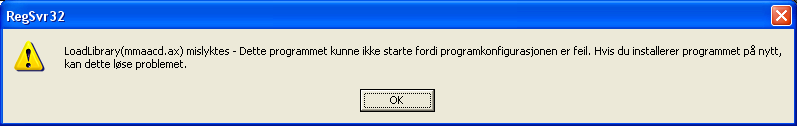

I couldn't register your filter, just got an error message (norwegian in picture) :
"LoadLibary(mmaacd.ax) failed - This program could not start, because the program configuration is wrong. Re-installing the program may solve this problem"
Edit: Forget it, hadn't installed the c++ sp1 fix :)
Edited by caid
