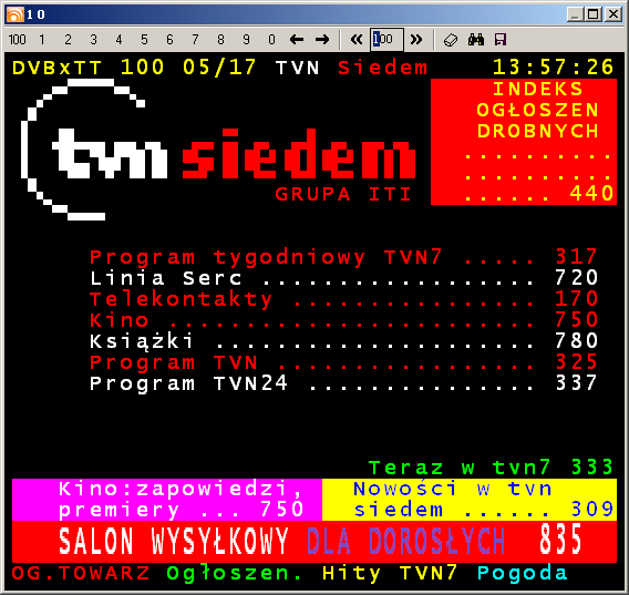

Adam T. Posted September 26, 2003 Posted September 26, 2003 Hi, I have problems with polish characters in EPG & TXT. In TXT options i have font with polish char. but on screen still %$&. You can check this on TVN, TVN Siedem - HB 11408V and TV Polonia - HB 11513H. How can i solve this problem? Quote

Adam T. Posted November 4, 2003 Author Posted November 4, 2003 Now the problem with polish characters is solved in 1.99R9. Thanks. .....but.... i don't have EPG on TVN and TVN Siedem - HB 11408V. In MyTheatre and ProgDVB everything is OK but in DVBViewer EPG fields are blank. Please help Thanks Quote
