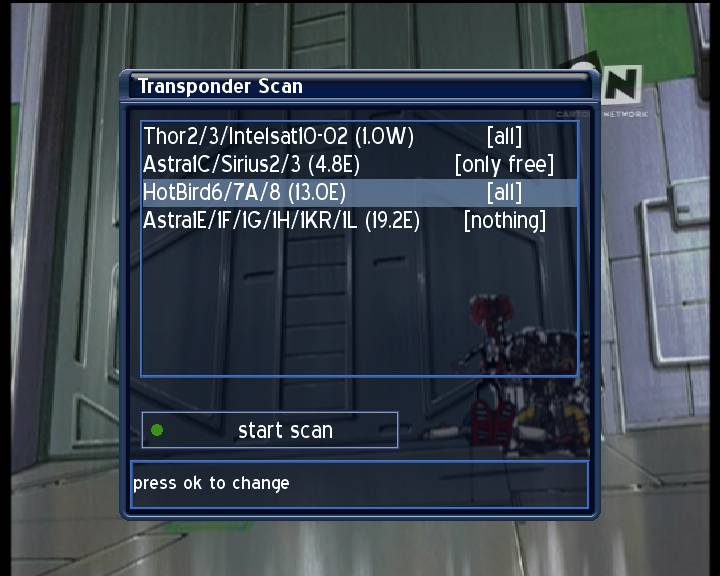

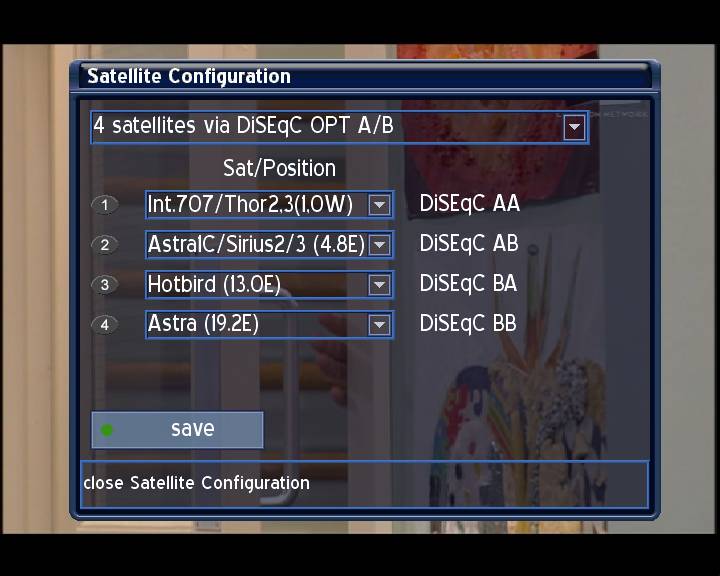

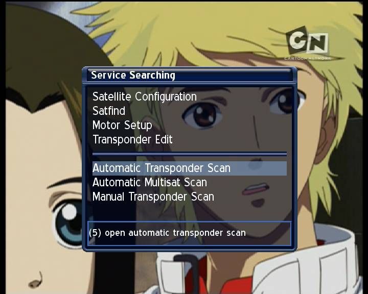

1. Select and set what hardware is present
2. Connect DiSeq / Motor and what have you to satellite(s) and SAVE and PERSIST this connection.
3. Scan 1 or more or ALL configured devices, without having to re-enter any of the above ever again(inside the same setup) unless the hardware's changed.
If f.ex a transponder list has changed just go to step 3 and one should be home dry. As it is now, at least in my end of things this setup is not a one-time-only
event as mentioned above as I too often have to reassociate DiSeq pos. and satellites.
For your viewing pleasure and inspiration, consider the 3 attached Dreambox 7020s screenshots...they might not be artistic wonders but it's one
good way of getting it right.
