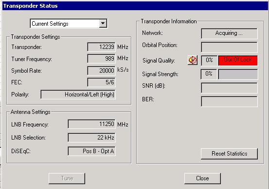

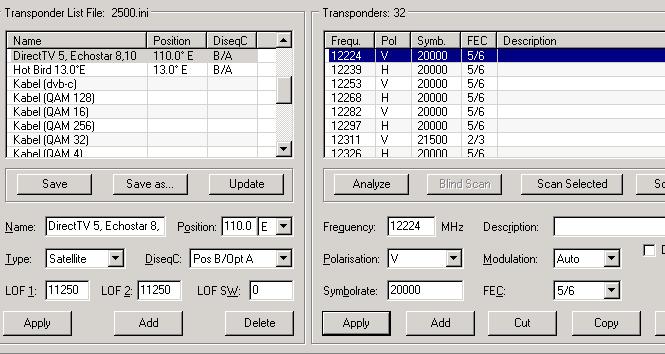

frenchy Posted January 9, 2008 Posted January 9, 2008 Hi All, I'm helping a friend with his first HTPC and was wondering if you can tell me wil this is happenning He purchase DVBViewer 3.9.1 and from what I can see the scanning function is not working properly. to be sure I've donwloaded TransEdit from your site and I get the same thing. Here's the issues when trying to scan Echostar 8/10 110w with both product the software sets up the all of the proper scan parameters except one, it seem to always use 22kHz in lnb selection. I've attached a few pictures to show you my problem scan1.jpg is the tansEdit settings, scan2.jpg is pc4server reporting the status.. If you can make this work I'll probably buy 5 copies of this product and know many people that will to Thanks Hugues Quote
Derrick Posted January 9, 2008 Posted January 9, 2008 If you don't use an universal LNB (default) you have to change the settings accordingly. Do you have a single band LNB ? Then 22kHz can't do any harm If you want no 22kHz then you have to set the switching frequency (LOF SW) to the highest possible frequency. That mean for KU-band 12750 MHz. Quote
Griga Posted January 9, 2008 Posted January 9, 2008 If you want no 22kHz then you have to set the switching frequency (LOF SW) to the highest possible frequency. Not necessary for TransEdit. Read here (after the exclamation mark icon): http://www.DVBViewer.com/griga/TransEdit%2...#ListProperties Quote
Derrick Posted January 9, 2008 Posted January 9, 2008 ..nice but though I've missed this part, my method will work as well Quote
