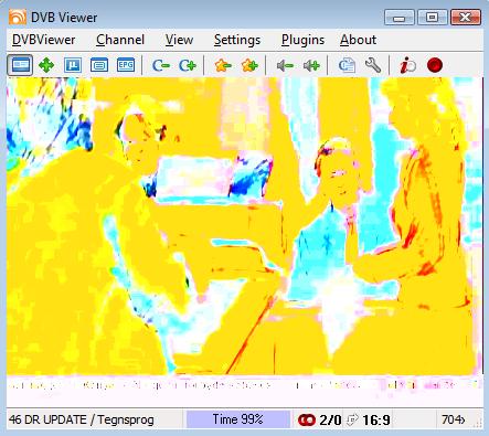

TJMacGyver Posted April 18, 2008 Author Posted April 18, 2008 Just an example picture of how it looks. And for some reason I can't use "Unchanged" or "Overlay Mixer" anymore. Which I was on both the last computer and this one before I reinstalled. Quote
maier2505 Posted April 18, 2008 Posted April 18, 2008 Just an example picture of how it looks. And for some reason I can't use "Unchanged" or "Overlay Mixer" anymore. Which I was on both the last computer and this one before I reinstalled. Hi, again ! This is definitely not the effect I described with the expanding... With expanding you get a slight grey instead of black, but not that... I have really no guess where that comes from... I am using Vista together with DVBViewer only with EVR, I cannot use overlay either... But with EVR everything should be o.k. Is this picture with enabled Cyberlink Codec ? Best regards maier2505 Quote
TJMacGyver Posted April 18, 2008 Author Posted April 18, 2008 it looks like this with EVR no matter which codec is used Quote
