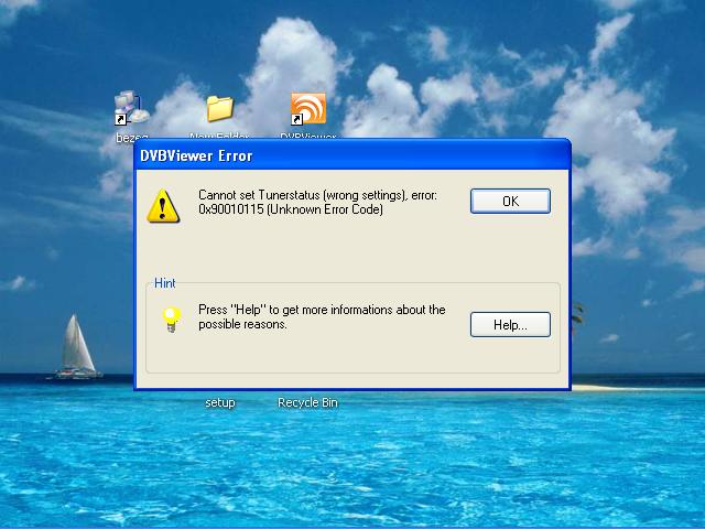

joshavin Posted November 22, 2003 Author Posted November 22, 2003 hi i re instald the tecenysat and dvb full a version find a tached the error msg right after starting the DVBViewer thank for all your work i am wating for amircale josh Quote
Klausing Posted November 22, 2003 Posted November 22, 2003 It would be nice if you only post the picture with the error message and not the complete screen. And your first picture is not complete. And please more informations! Which driver version? Do you get this message on all tv station??? When you get this message? Is TV4PC running? Had you errors during installation? Have you made a channelscan? Had you deleted all old drivers and directorys before you reinstalled the driver? ................................. Quote
joshavin Posted November 22, 2003 Author Posted November 22, 2003 hi iget this messege when i am openning the DVBViewer all is working exept the ch list ileft the basic version and then i put yhe full version thanks josh Quote
Klausing Posted November 22, 2003 Posted November 22, 2003 what is if you raise the resolution to 800x600? Quote
joshavin Posted November 22, 2003 Author Posted November 22, 2003 thank you it is working on 600 800 i got ch list now how can i add a station like nbc on 30 w 11516 h 3742 once again thank you Quote
