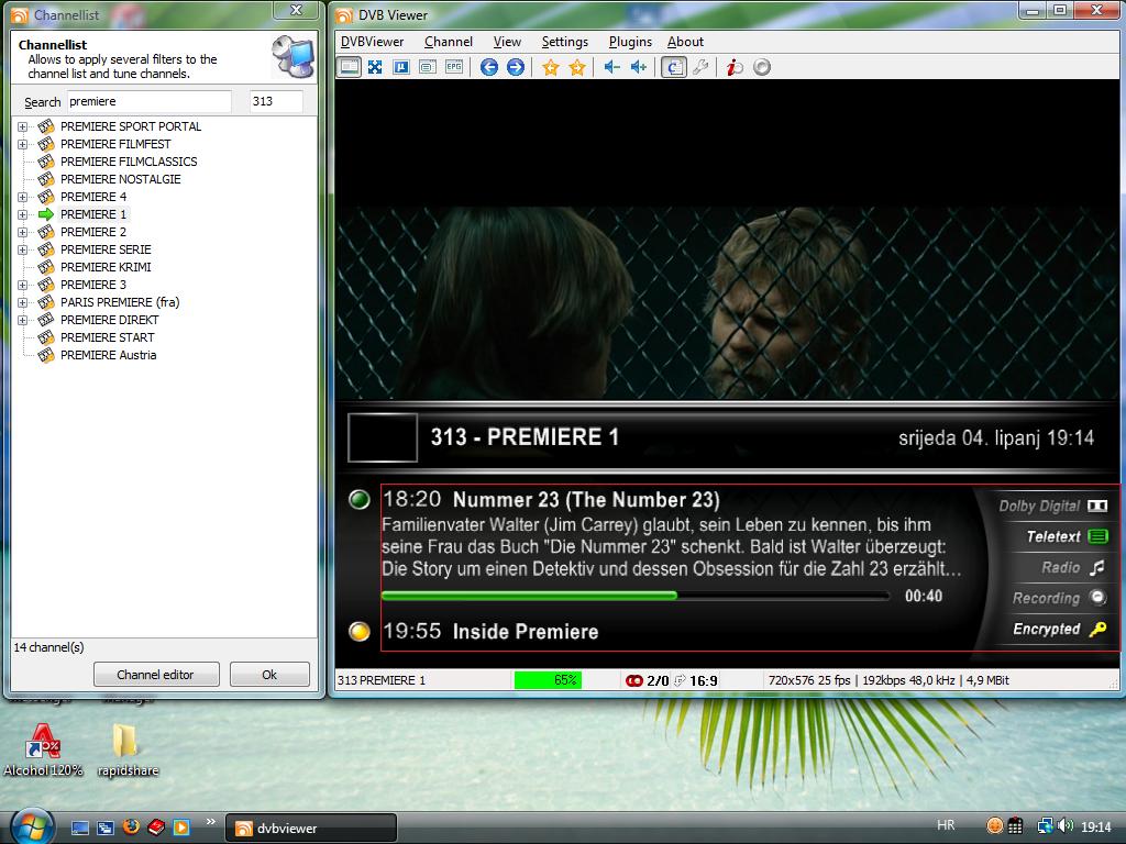

Muddy OSD on Vista Ultimate SP1
miro111hrzg
Best Regards,
I have to say that OSD is often very muddy on vista, as you can see on this picture.
I don't know why. On Windows XP it was very clear.
I use EVR Vista Enhanced for video rendering. DVBViewer Vesrion is latest 3.9.4.0
Do you know why?!
support.zip is also attached
Edited by miro111hrzg
here is better visible:
Try a HD skin and the result will be much worse.
E.g. concinnity 3D
I must admit I'm not a lover of Vista, I installed it just to see what's new and fixed in last SP1.
As I can remeber, system would change theme when I would start DVBViewer to vista classic, but now works with aero theme and that's good.
It was pretty iritating to watch every program changing the theme. :)
