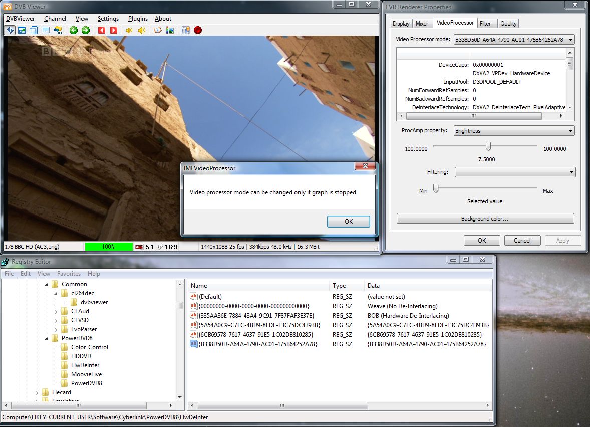

Imbalanced Zero Posted June 28, 2008 Posted June 28, 2008 Is it possible to add an option to change Video Processor Mode? Under EVR Properties there is a page for Video Processor Mode. If I stop the graph and change Video Processor Mode from {6CB69578-7617-4637-91E5-1C02DB810285} (Pixel Adaptive Deinterlacing) to B338D50D-A64A-4790-AC01-475B64252A78 (Bob Vertical Stretch), performance appears to be a lot smoother especially when watching HD Video like BBC HD. Pixel Adpative seems want to work out what type of deinterlacing is appropriate for the scene, whereas using Bob Vertical Stretch seems to be fixed. Does that make any sense? Quote

Imbalanced Zero Posted June 29, 2008 Author Posted June 29, 2008 (edited) How? AFAIK DVBViewer Pro doesn't allow to stop a live playback graph, at least not in the control bar. I'm using Geforce 8600M GT with Cyberlink PowerDVD 8.0 Codecs. I connect to the graph in graphedit. Pause it, stop the graph, then change the video processor mode in EVR Properties and press play back in Graphedit. It seems to get the compatible modes from a key in the registry set by PowerDVD (HKEY_CURRENT_USER\Software\Cyberlink\PowerDVD8\HwDeInter). If I try and change the video processor mode without stopping it in Graphedit I get this (In the picture I have tried to choose B338D50D-A64A-4790-AC01-475B64252A78 but the actual current mode is 6CB69578-7617-4637-91E5-1C02DB810285) : Edited June 29, 2008 by Imbalanced Zero Quote
Griga Posted June 29, 2008 Posted June 29, 2008 It seems to get the compatible modes from a key in the registry set by PowerDVD It's very unlikely that a Microsoft video renderer reads Cyberlink keys. It rather querys the graphics card driver for the available modes. Anyway, in the end it comes down to making your preferred setting permanent. That's what a plugin could do, but additionally it must provide means to select the mode, similar to the EVR property page, and that looks like some work... I will think about it. Quote
