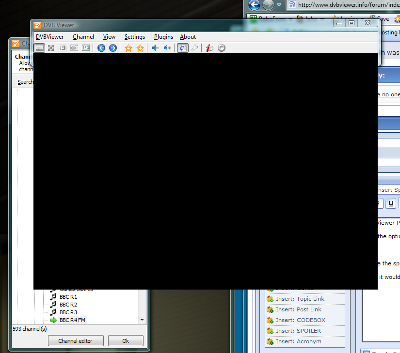

With the option "Hide Display in Radio Mode" ticked and a radio station selected, the window looks like this:
Notice the spurious black "toung" hanging down over the bottom boundary of the window!

vista evr bug. try another renderer for testing and you see it does not happen.

But I've not got an OSD anyway, just a (square) black hole in my screen! :(
After posting the original message I discovered I could get both a minimised Radio display and a radio OSD by selecting a skin option. However in the instalation default with no skin, there is also no OSD. If I start the program and select a radio channel, the renderer is either not started or reduced to zero height. If I switch from a TV to a radio in this mode I get the renderer "toung", but nothing is displayed on it, hence my suggestion that it may as well be shut down.
