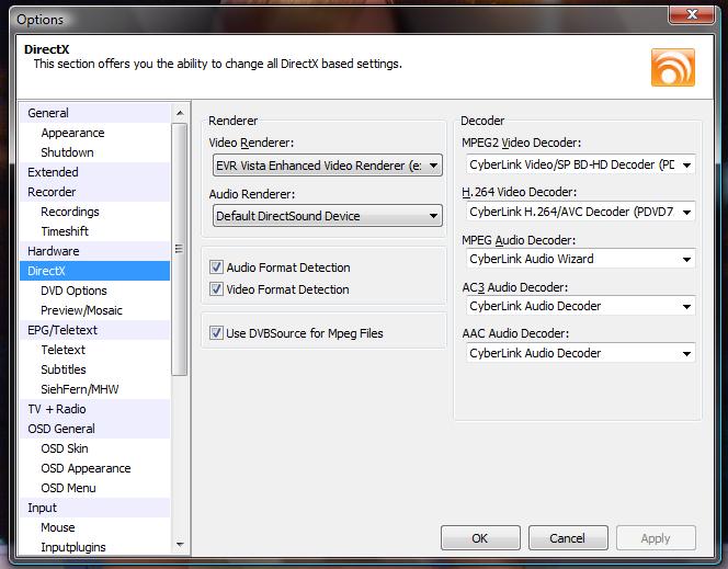

qubito Posted August 23, 2008 Posted August 23, 2008 Graphics Card - 780G motherboard integrated graphics (ATI HD 3200) - Gigabyte GA-MA78GM-S2H (h**p://www.giga-byte.com/Support/Motherboard/Driver_Model.aspx?ProductID=2758). CPU - AMD Athlon X2 BE-2400 CCC - 8.8 (just released by ATI). PDVD - v.7.3 (H264 Codec). See attachment for DVBV settings. EVR works ok in DVBV with PDBV 7.3. CPU usage on BBC HD playback 12-17%. Playback of 1080p HD .ts file ~5-7%. CoreAVC 1.7 - currently only works with VMR9 in DVBV - CPU usage around 54-58%. I get aspect ratio isues using CoreAVC + EVR. Quote

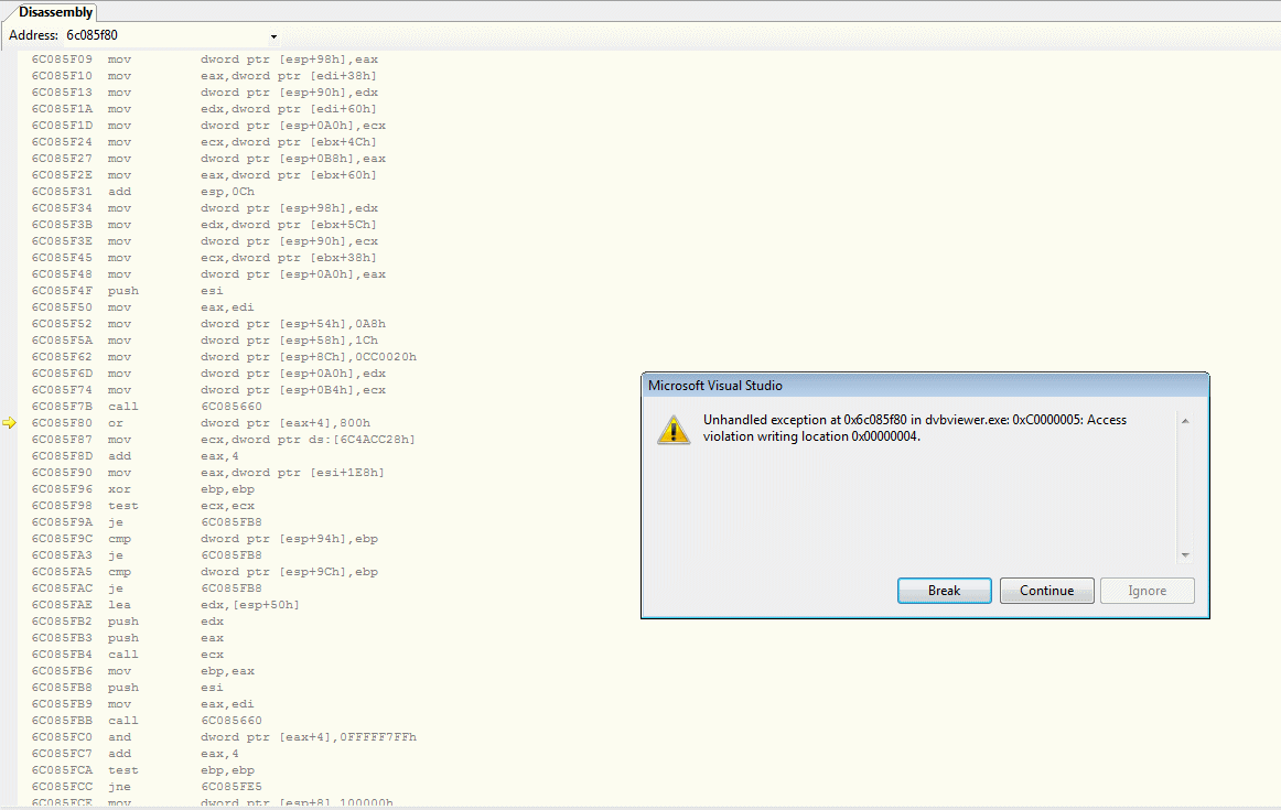

TeaTray Posted August 28, 2008 Posted August 28, 2008 As a newbie to DVBViewer, I have to report the following: BBC HD crashes the program, whichever AC3 and H264 codecs I use. The image shows the debug view. In all other respects, so far, I'm happy with the program. It does what I want and more - the mark of good software. Quote
