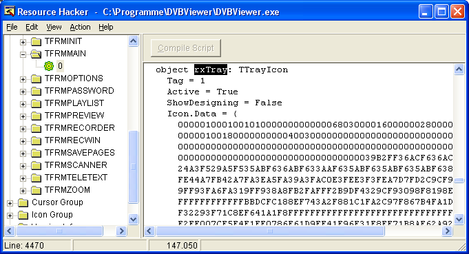

How do you charge the Systray icon via the shortcut config? ;)
A resource editor is although no solution. Because there it is only possible to cage the main icon but not the Systray icon (at least in the three editors i tried).
There is a possibility to change the tray icon. But it's quite complicated, because it has to be entered as hex dump:
