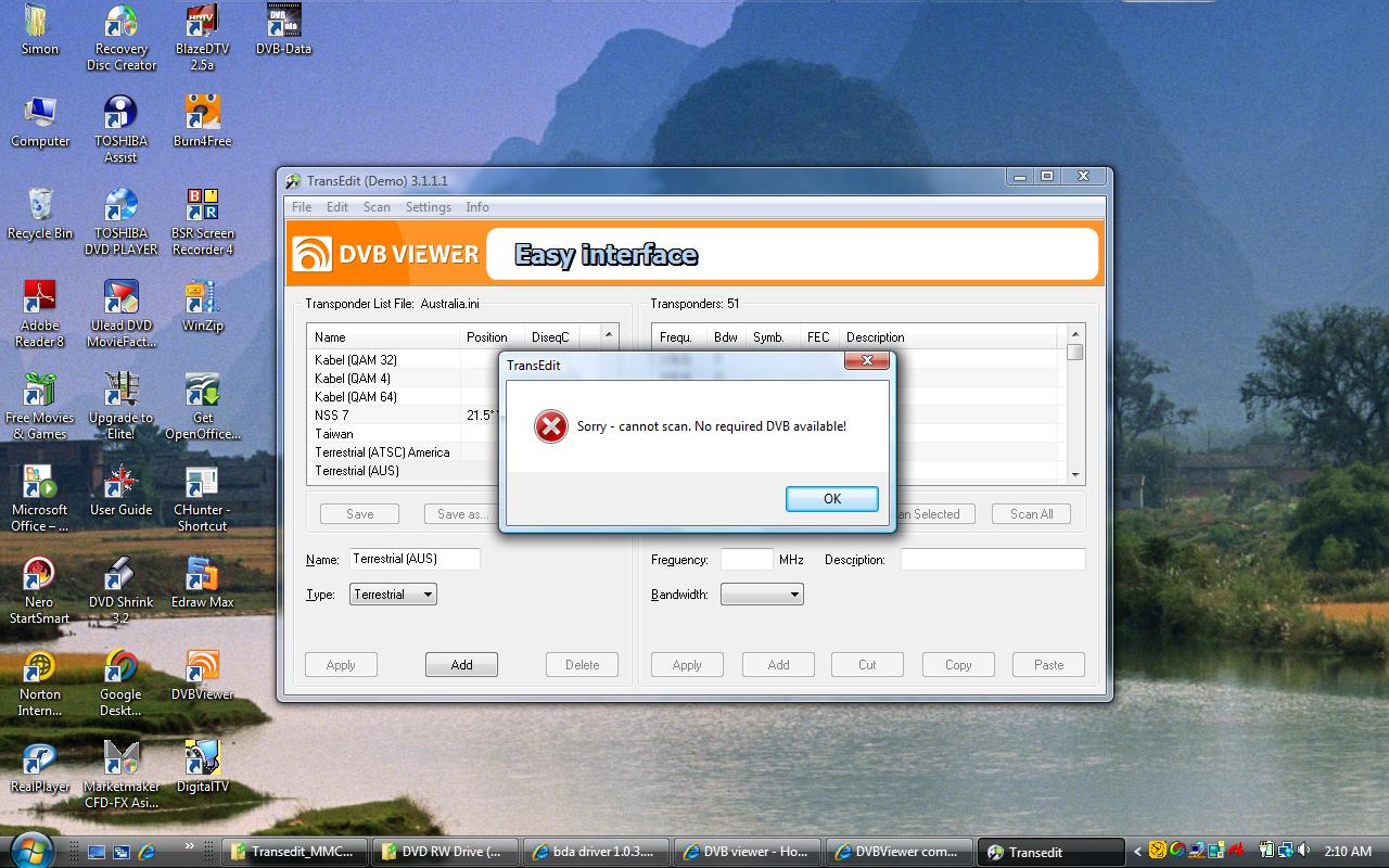

I've just bought Twinhan 7047S DVB-T USB2.0 TV Stick. However, transedit cannot find this device. The following are the readme of the device. Looks like BDA driver is not supplied with the installation. I only got one for XP only. Please advise where can I download one compatible with Vista. Thanks.

After a thousand time of uninstall & reinstall everything, I finally reach a stage that I can watch free to air TV. I don't know what makes that changes because nothing new has been actually installed. But now the big problem is the extremely low % reading (1% - 3% only) shown in the bottom section of the program as shown in pic3.jpg. When recording subtitle, that created an error .ts file that subtitle cannot be shown in other software.
Another rare situation is that I do have a REALTEK 2831U_BDA filter installed. But TransEdit cannot see it. It always shows no required dvb available.
Is there any solution? especially anything I can do to correct the extremely low % reading? Thanks.

The bundled tv application gave approx 49% - 55% signal strength. When the quality climbed above 70%, that frequency would give one group of channels (they're actually the same channel with different names). Theoretically, DVBViewer should show at least 49% when showing a valid channel. But it now only show 1% to the highest of 5% (so far I can find up to date).
I've got another quite lousy usb dvb-t stick but DVBViewer could show at least 60% for all valid channels. The only problem is that stick can only tune a few channels. So according to your "SUPPORTED DVB DEVICES" menu, I find "TWINHAN DVB-T USB", and therefore I bought one to try fixing the problem. But it didn't. I found that with the old stick, DVBViewer hardware option can actually read that device "USB DVB-T TV TUNER". But with Twinhan stick, it can only read "REALTEK 2831_BDA FILTER", which is not the tuner. Nor TransEdit can read this device at all.
The next problem was that I did try to ask help support from Twinhan for more than a week, trying to contacting them everyday. But its website cannot link up to support centre, email address not working and help desk is no man land! Maybe I should post this to the suggestions & ideas section. PLEASE MAKE RESERVATIONS TO YOUR LISTING OF "TWINHAN DVB-T USB", WARNING NOT ALL TWINHAN DVB-T USB IS COMPATIBLE WITH DVBViewer. ANYONE BOUGHT THESE PRODUCTS MAY NOT GET HELP FROM TWINHAN. IF NOT SURE, PLEASE CHOOSE SOMETHING ELSE.

Yes, I accept that my aerial can only give me 60% of available free to air channels for DVB-T sticks. But with that 60% valid channels I can receive with the bundled tv applications, DVBViewer gave none of them an acceptable %. As I wrote previously, only 1%-5%. And TransEdit cannot even see this stick.
