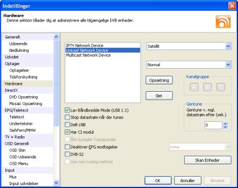

hmm tuner type on client?
On client i have "3 units listed" as in the attached image (IPTV, Unicast & Multicast).
But no Skystar 2 USB device?
Does it influence if DVBViewer is running on server PC at the same time the DVBserver is running?
You need to configure the unicast devices on the client with the same values like the skystar 2 usb device on the server.
