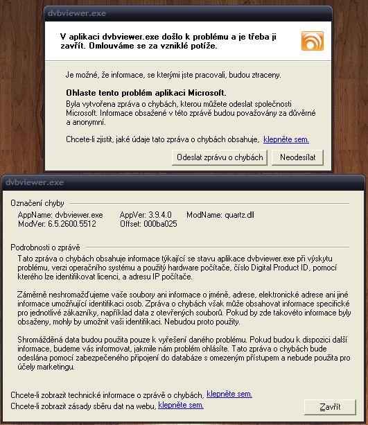

Hello, I have following problem, my DVBViewer crash when starts on second monitor (it starts normaly on primary, but i closed the DVBV window on second monitor last time and DVBViewer remember last window position). I can only start DVBViewer in safe mode and move it to primary monitor and then start it again in normal mode, than when its running i can even move it to second monitor without problem. Is there any way to solve this crash? or at least to force DVBViewer window to start on primary monitor where it won't crash. The error message screenshot and support.zip is attached bellow.

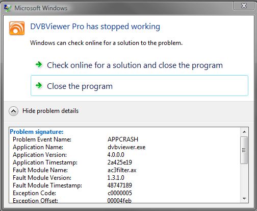

I too get this problem, support.zip attached.
Any ideas?
