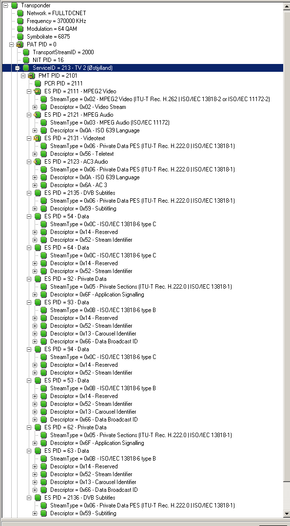

amigasger Posted January 27, 2009 Posted January 27, 2009 (edited) Hi again Lars Here is my transedit analyse - it looks like their actually is a EIT. I have noticed the space and the ( ) , maybe they can break the EPG in DVBViewer ? I have expanded DR1 as well - since the EPG works well on that channel. /A\mig/A\sger Edited January 27, 2009 by amigasger Quote

amigasger Posted January 27, 2009 Posted January 27, 2009 is it "Read Extended Event Descriptors" I need to check - or is it "Read EIT for other transponders / networks" - can you tell me what to look for afterwards ? I got MPEG2 Video, MPEG Audio, Videotext, AC3 Audio, DVB Subtitles, Data, Data, Private Data, Data, Data, Data, Private Data, Data and DVB Subtitles. Which one should I expand? I cant find the word EPG/EIT in any of them. Quote
Lars_MQ Posted January 27, 2009 Posted January 27, 2009 No EPG in the stream? You should see something like this. You can read more about it here. Look out for PID 18 (12 in hex). Is it there? Quote
amigasger Posted January 28, 2009 Posted January 28, 2009 No EPG in the stream? You should see something like this.You can read more about it here. Look out for PID 18 (12 in hex). Is it there? I dont see the green EI-box at all - no matter what settings I scan with. I cant find PID 18 (12 as hex) either. Quote
Lars_MQ Posted January 28, 2009 Posted January 28, 2009 Don't open the PAT part of the tree and please post a screenshot with all rootlevel elements. You won't find the EIT PID in the PAT/PMT data... Quote
deco Posted January 28, 2009 Posted January 28, 2009 Don't open the PAT part of the tree and please post a screenshot with all rootlevel elements. You won't find the EIT PID in the PAT/PMT data... a little input from your best friend again , i just tried the program that came with FireDTV which IS a old version of DVBViewer (don't make me hex it to identify which version) and funny enough this ALSO shows epg?! so something HAS changed, sadly there's no transedit with the firedtv version of DVBViewer so i can't analyse.. -Deco Quote
amigasger Posted January 28, 2009 Posted January 28, 2009 Well.. As I said - there is no EI green-block like yours. Now I have expanded the SDT-tree - so now you should have my full analyse (and all the root-elements). Quote

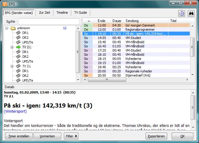

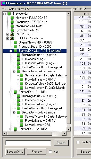

deco Posted January 28, 2009 Posted January 28, 2009 ok i did a analyze too now and got this: and this looks like there's indeed epg info there, but it dosn't show up on the epg like other transponders do. -Deco Quote
deco Posted January 28, 2009 Posted January 28, 2009 well fact is that there IS epg in stream, the old DVBViewer shows is, the new one dosn't where do we go from here -Deco Quote

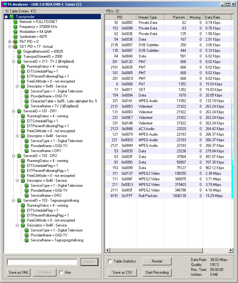

Lars_MQ Posted January 28, 2009 Posted January 28, 2009 The fact is, I have two sources, one says there is no EIT at all, one says there is. @deco Can you upload a transponder dump (select all PIDs on the right side of the analyzer window and click start recording) somewhere and send me the URL via PM please? 75 - 100 MB should be enough, more is welcome but not necessary I'll examine the dump and hopefully find something. Quote
amigasger Posted January 28, 2009 Posted January 28, 2009 The fact is, I have two sources, one says there is no EIT at all, one says there is. @deco Can you upload a transponder dump (select all PIDs on the right side of the analyzer window and click start recording) somewhere and send me the URL via PM please? 75 - 100 MB should be enough, more is welcome but not necessary I'll examine the dump and hopefully find something. Yes - it seems really weird - because I get EPG on DR1, DR2 - but not on TV2. And Transedit dont give me the EIT-block for DR1 and DR2 either.. I guess deco got a better result for examination... Quote
amigasger Posted January 28, 2009 Posted January 28, 2009 Yes - it seems really weird - because I get EPG on DR1, DR2 - but not on TV2. And Transedit dont give me the EIT-block for DR1 and DR2 either.. I guess deco got a better result for examination... I can see that DR1 and DR2 (on freq 370) gets the EIT from freq 538 - on that freq isnt containing the EIT from TV2. I cant find the EIT for tv2 on any other freq's. Quote
Lars_MQ Posted January 29, 2009 Posted January 29, 2009 thanks to @deco I have now a transponder dump and tested it. I'm sorry to say but there is nothing wrong. This is getting quite mysterious. Could somebody please PM me his channels.dat? I only need the channels from the transponder in question... Quote
deco Posted January 30, 2009 Posted January 30, 2009 thanks to @deco I have now a transponder dump and tested it. I'm sorry to say but there is nothing wrong. This is getting quite mysterious. Could somebody please PM me his channels.dat? I only need the channels from the transponder in question... yep, just pm'ed you, and yes this is weird lol cause it looks sweet on your screenshots :/ -deco Quote
Lars_MQ Posted January 30, 2009 Posted January 30, 2009 Your network ID is wrong in the channel details. Please replace 65025 with 65024 in the channeleditor. don't forget to press update for each channel. And another thing: Please Scan the frequency again and don't select update. Does it find the correct Network ID? Quote
deco Posted January 30, 2009 Posted January 30, 2009 Your network ID is wrong in the channel details. Please replace 65025 with 65024 in the channeleditor. don't forget to press update for each channel. And another thing: Please Scan the frequency again and don't select update. Does it find the correct Network ID? OMG thats it?!, you're the man! but how did this become that way, i never touched that one, and it's the same on a brand new install after a full scan (and been this way for loooong time, as long as i can remember, years..) -Deco Quote

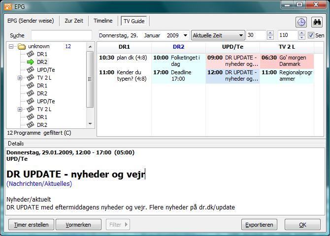

amigasger Posted January 30, 2009 Posted January 30, 2009 Most likely the cable company (or tv station) changed the value recently. That's a very ugly thing to do. because this value is a key ID which identifies a channel and is not corrected by the auto channel update. I changed the network id as well - and now the EPG is working here as well.. I send you a big HUG from Denmark as well /A\mig/A\sger Quote
