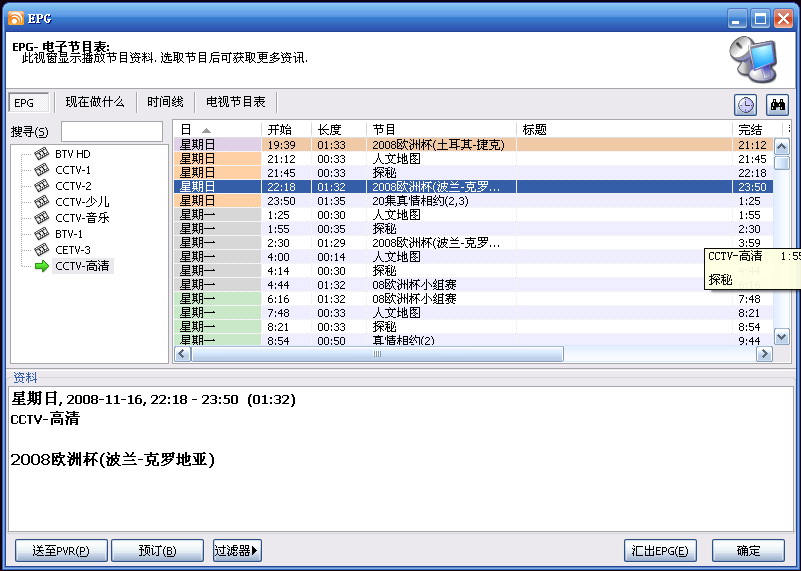

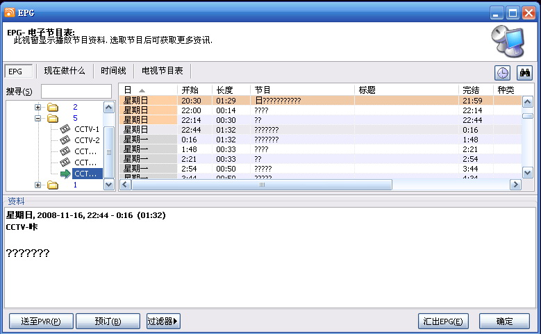

Recycle Bin Posted November 16, 2008 Posted November 16, 2008 (edited) I'm a registered user using DVBViewer to watch terrestric programes provided by CCTV(China Central TV Station). When I use 3.9.1 version. the epg works well. but when I upgraded it to 3.9.4. the chinese characters in epg are all "?" question marks.. I tried 3.9.4.0, 3.9.4.40, 3.9.4.99. the problem remains the same. Edited November 16, 2008 by Recycle Bin Quote

tulipyun Posted December 12, 2008 Posted December 12, 2008 I have same problem too.(DVBViewer 3.9.4.103 beta) but traditional chinese characters are right,Simplified Chinese characters are all "?",notice that traditional chinese and Simplified Chinese are difference,traditional chinese encoding is BIG5,Simplified Chinese encoding is GB2312. 3.9.1 the epg works well for Simplified Chinese,but Taditional Chinese characters are all unraed-able,3.9.4 beta works well for Taditional Chinese,Simplified Chinese characters are all "?". Quote

tulipyun Posted March 30, 2009 Posted March 30, 2009 plz fix this bug:) I tested 4.0.1.40 beta,both traditional and simplyfied chinese epg displays NOT correctly! Quote
