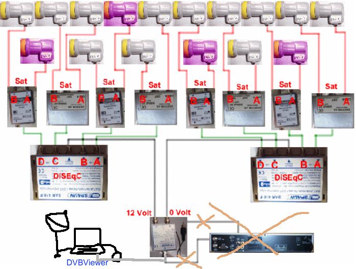

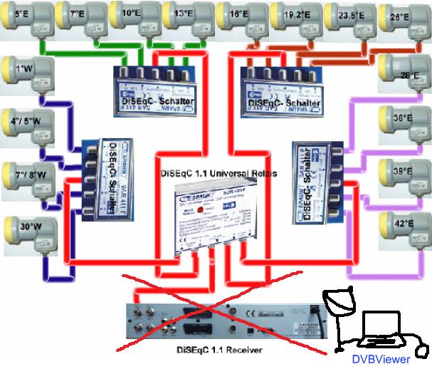

Reza Sadeghi Posted February 13, 2009 Author Posted February 13, 2009 Thank you for your Replies. I try to show you the way i need to use DVBViewer to reach more than 4 LNB at the same time by these pictures i attached in this post. could you please tell us which one is the correct way and DVBViewer will support ? I have 2 Nokia DiSEqC 4 to 1 Switch. so what else do i need exactly to watch TV Channels from 8 LNB at the same time by DVBViewer on Technisat Skystar USB 2 HD CI ? Quote

Griga Posted February 22, 2009 Posted February 22, 2009 I'd try the latest DVBViewer Pro Beta. It makesDiSEqC 1.1 handling much easier than version 4.0. Everything you need to know about DiSEqC can be found in the TransEdit manual: http://www.DVBViewer.com/griga/TransEdit%2...SEqC.html#Title Please take note of the "Hints for DVBViewer Pro" sections. Quote

Valts Posted January 12, 2010 Posted January 12, 2010 Well I want to give feedback on using diseqc 1.1 with TT S2-3200. In short it works - I have setup cascade of 8port 1.1 switch + 4 port 1.0 switch with dvbv 4.2.1.0 I have set it as for example like this: 1) Switch Uncommited 5 2) Internal Delay 100 3) Switch Commited [unchanged] 3 (A/:) So the actual hardware setup is: |TT S2-3200| -> | 5th port on EMP-Centauri P.168-W V2 | -> | A/B port on 1.0 switch| -> LNB Hope helps someone. Quote

Reza Sadeghi Posted April 12, 2013 Author Posted April 12, 2013 Hoorrraaa it works. now i'm using DVBViewer with 8 LNB at the same time by using DVB card called Technisat Skystar USB 2 HD CI. nowadays i purchased a Diseqc 1.1 Switcher (8 Input LNB and 1 Output) I used Extended Uncommited mode for each LNB in DVBViewer. now it has worked without any problem. thnak you DVBViewer developer team for this great DVB application. Quote
