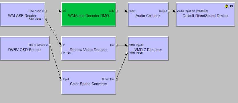

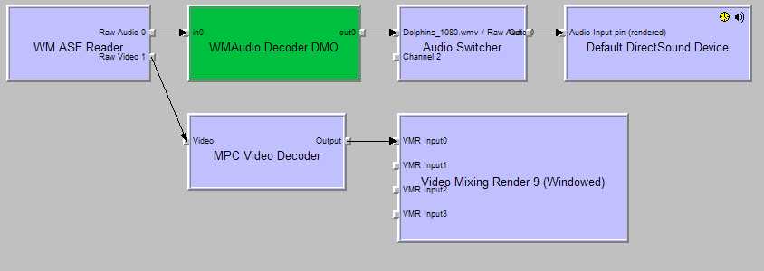

dvbrewer Posted June 14, 2009 Author Posted June 14, 2009 (edited) I've downloaded the Dolphins 720p sample, and here DVBViewer Pro/GE play it as 16:9. The video decoder is WMVideo Decoder DMO, and the source filter/splitter the WM ASF Reader (both MS stuff, visible under View -> Filters resp. in GraphStudio -> Connect to Remote Graph). WMV is not handled explicitely by DVBViewer. Playback is more or less delegated to DirectShow. It is up to the splitter filter to detect the resolution/aspect ratio correctly and expose the values on the video output pin, where DVBViewer picks them up. The problem is ffdshow and MPC decoder override the WMVideo Decoder for me and there seems to be an incompatibility with ffdshow and MPC and DVBViewer for these videos. In MPC-HC the WMV files plays correctly with MPC decoder. I have attached graphstudio graphs for playing this file in DVBViewer and MPC-HC. How do you know? I've just checked it again with a BBC HD recording and a hex viewer - here it works. All 00 00 01 C0 PES startcodes were replaced by 00 00 01 BD. Does the Stream Patcher item in the plugins menu show a checkmark after tuning BBC HD? If I tune to BBC HD the stream patcher is not ticked when tuning BBC HD, for Simply/World Movies, SuperCasino it is ticked as long as I don't tune from BBC HD. Edited June 14, 2009 by dvbrewer Quote
Griga Posted June 14, 2009 Posted June 14, 2009 there seems to be an incompatibility with ffdshow and MPC and DVBViewer for these videos. I'd say ffdshow somehow overrides the DVBViewer attempts to control the aspect ratio. Maybe you have to change one of the countless ffdshow options. Another possibility would be to change the DirectShow merit values of the decoders, so that the MS decoder becomes the first choice. Not so easy with DMOs. The current RadLight Filter Manager release doesn't suppot it yet. However, I've already uploaded an update (without announcing it), that is able to deal with DMOs: http://www.DVBViewer.com/griga/rlfm_bin1_6_1.zip the stream patcher is not ticked when tuning BBC HD Some channel data difference, I guess. Compare it, or create your own patch file by exporting BBC HD (AC3) as INI and adding the PatchType entry. A hint for aspect ratio patching: For me it was quite easy to export all to-be-patched channels to one ini file because I've implemented multi-selection in the DVBViewer GE channellist lately (not yet released). In DVBViewer Pro I would do it in the following way: 1) Select one of the channels in the DVBViewer Pro channel editor and give it a new (not yet existing) category name. Click Apply. DVBViewer will create the new category. 2) Drag & drop the other channels into this category. 3) Select the category and export it (resp. all contained channels) as INI. After that, click the "Reload channellist" tool button to return to the previous state. 4) Add [Patch] PatchType=16:9 in the INI export, rename it to .patch, store it in the configuration folder. Quote
dvbrewer Posted June 15, 2009 Author Posted June 15, 2009 I'd say ffdshow somehow overrides the DVBViewer attempts to control the aspect ratio. Maybe you have to change one of the countless ffdshow options. Another possibility would be to change the DirectShow merit values of the decoders, so that the MS decoder becomes the first choice. Not so easy with DMOs. The current RadLight Filter Manager release doesn't suppot it yet. However, I've already uploaded an update (without announcing it), that is able to deal with DMOs: http://www.DVBViewer.com/griga/rlfm_bin1_6_1.zip Can it be an ffdshow option if the same thing happens with MPC? I know MPC and ffdshow are related but I'm not sure what setting would have to be changed. Thanks for the radlight update, it is very good tool which I already use so great to have this new version- I'll try it out tomorrow . Some channel data difference, I guess. Compare it, or create your own patch file by exporting BBC HD (AC3) as INI and adding the PatchType entry. I think it is the DiseqC as I have no switch, in your patch DiseqC=9, DiseqCValue=282, I changed both to 0, now it seems to be working - stream patcher is ticked on BBC HD . Unfortunately the bug is still there if you switch from BBC HD to an aspect ratio patched channel- can this be fixed? If it's too hard don't bother, I can just go to another channel first. A hint for aspect ratio patching: For me it was quite easy to export all to-be-patched channels to one ini file because I've implemented multi-selection in the DVBViewer GE channellist lately (not yet released). In DVBViewer Pro I would do it in the following way: 1) Select one of the channels in the DVBViewer Pro channel editor and give it a new (not yet existing) category name. Click Apply. DVBViewer will create the new category. 2) Drag & drop the other channels into this category. 3) Select the category and export it (resp. all contained channels) as INI. After that, click the "Reload channellist" tool button to return to the previous state. 4) Add [Patch] PatchType=16:9 in the INI export, rename it to .patch, store it in the configuration folder. Thanks for the tip, but I can't see how to create a category in the channel list editor- I can only see 'set channelgroup' (A-H)? Quote
