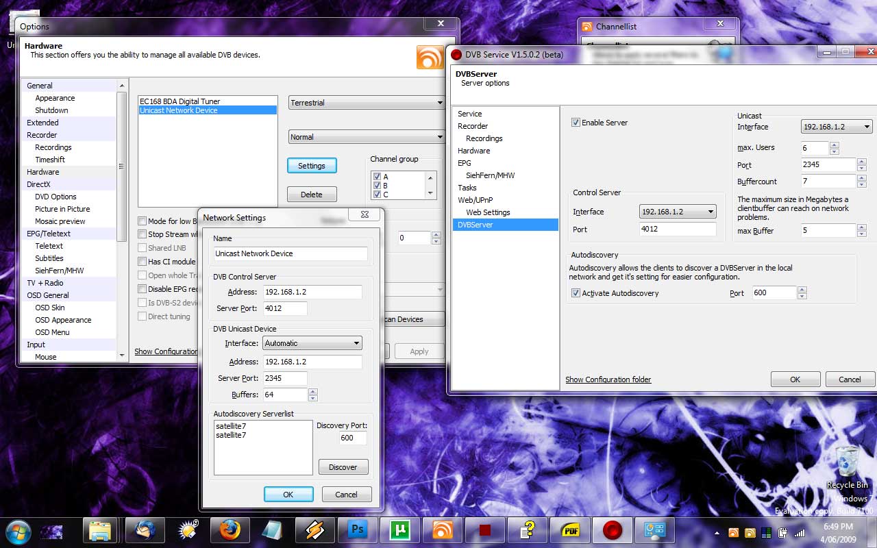

miss_mel Posted June 4, 2009 Author Posted June 4, 2009 Did you add a unicast device and configurate it via Autodiscovery Serverlist?http://en.DVBViewer.tv/wiki/Unicast_Networ...very_Serverlist yes, mine looks like this attached picture I test recording through web interface and it worked. but, if I want to watch a live tv in DVBViewer, do I have to change the hardware settings back?
Devastation Posted June 4, 2009 Posted June 4, 2009 Even if you used autoserver detection please check in the RecordigService DVBServer options wether the controlserver and unicast-Serverports are correctly identical. Is the controlserver IP set to use always the same IP and not to dynamic? And is your tunerhardware in DVBViewer set to "do not use"?

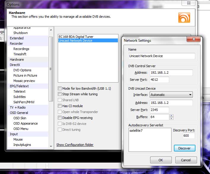

miss_mel Posted June 4, 2009 Author Posted June 4, 2009 Even if you used autoserver detection please check in the RecordigService DVBServer options wether the controlserver and unicast-Serverports are correctly identical. Is the controlserver IP set to use always the same IP and not to dynamic? And is your tunerhardware in DVBViewer set to "do not use"? They are identical now? I think.. see new picture yes, in DVBViewer options hardware setting my device is set to "do not use" I changed the port numbers to make them match.. and now if I click on a channel it is just a black screen. no picture no audio. But it says playing, and the timer at the bottom is ticking
