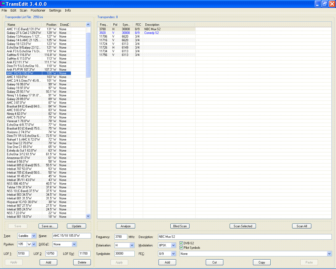

Description off issue -> My 18" LCD 4:3 Compaq monitor was set at 1280 by 1024 pixels upon
installation of DVBViewer and TransEdit. TransEdit window was very small and I could not read
the figures. I looked for settings to change inside TransEdit, but could not find any available.
I changed my display to 800 by 600 and can now view the figures in TransEdit, but 800 by 600 is unsatisfactory to many other apps.

No trouble here with a 1280 x 960 19" 4:3 CRC monitor. Please attach a screenshot.
The "missing dll" is probably caused by a DirectShow filter (e.g. video or audio decoder). Try to select others on Settings -> Preview.

I am not sure how you wanted the screenshot, so I hit 'Print Screen' button on upper right of keyboard, then pasted to 'Paint' program, and then saved as a .gif to save space.
I am 57yo and have eyeglasses optimized for computer screen use, but the data in each box is still quite small and difficult to read. I wish there was a way to increase it's size as you can hit Ctrl + '+' to increase the size of web pages in FireFox.
Also in the Screenshot, you will notice AMC 15/18 105.0°W, and transponder 3780H 30000 NBC Mux S2.
I receive audio on this mux, but no video and some kind of exception popped up when starting DVBViewer. I think it is because when I performed an 'Analyze' on the Mux, it indicated H.264 video. And under the Settings -> Preview -> H.264 Video Decoder, there is not anything listed.

Well, the screenshot looks normal to me.
That's difficult to achieve. TransEdit is not rendered as a web page, you know... maybe you should generally switch from 96 to 120 dpi fonts in Windows.
