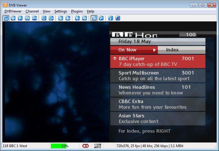

I made a small video which shows the current state:
Christian

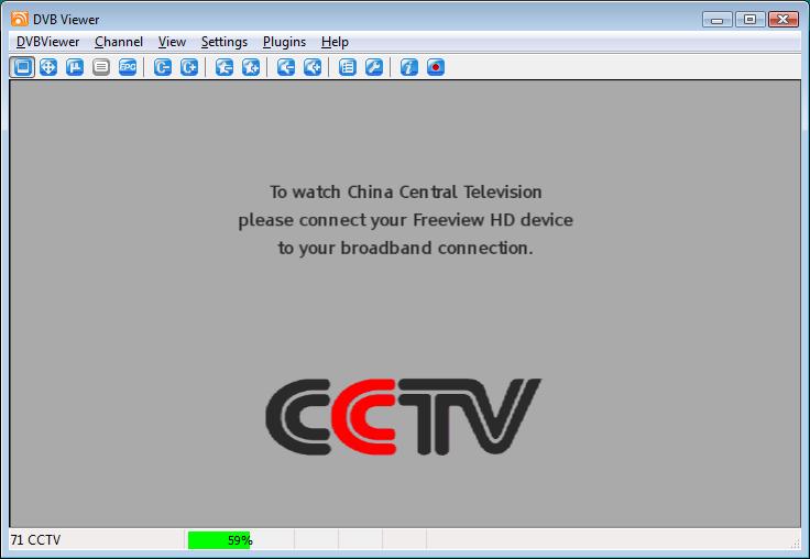

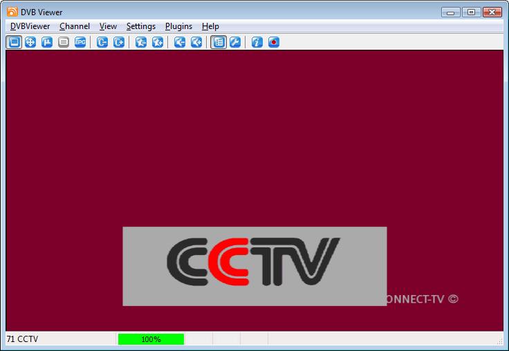

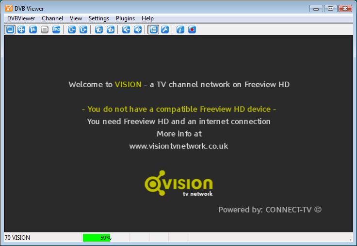

There are some new MHEG-IC services on the UK DVB-T platform.
Currently they don't seem to work and show the following MHEG screens.
The messages are around not being compatible or not being connected to the internet.
Is there still work ongoing around the MHEG-IC?

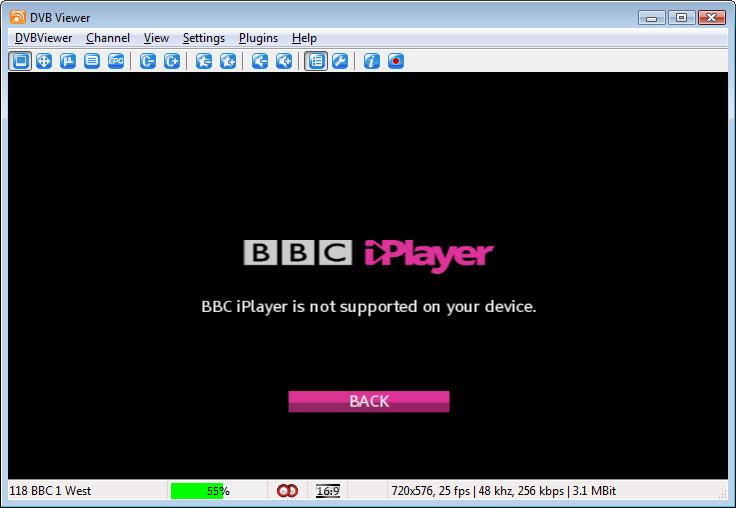

Also if you follow the advice of this thread http://www.DVBViewer.tv/forum/topic/45409-iplayer-in-mheg/ and change the setup file to enable MHEG-IC, the behaviour changes.
With the DTT IC services, the application freezes on a screen but doesn't present the same message.
And although the Freesat red button now offers the iPlayer - when selected it is not supported.

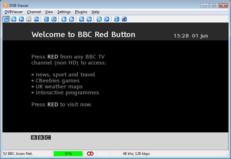

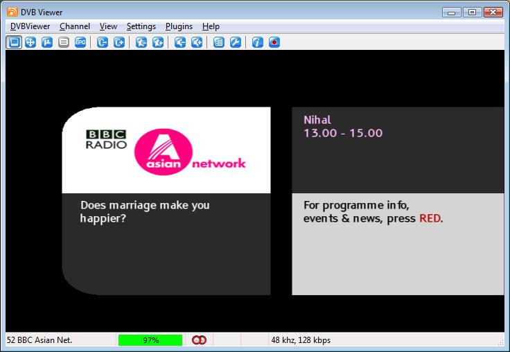

I have also noticed that when the MHEG-IC is enabled in the setup.xml, the MHEG applications on the BBC radio channels launch incorrectly.
Instead of loading the graphic and programme information:
It launches a generic BBC Red Button page:
