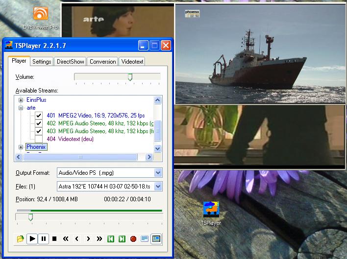

Griga Posted March 7, 2010 Posted March 7, 2010 Well, that already looks like something... The DVBViewer GE PiP module (now attached to TSPlayer) is quite flexible. The PiP window can be moved to any desktop position, resized, switched to full screen, etc. Seeking works, even cue play, pause and all that stuff... the most difficult part was to sync the two video windows. At first the PiP window tended to be one second ahead, but I managed to reduce it to 100 ms or so. It has reached the state of being a proof of concept, I'd say. However, there are still some things on the to-do list. Switching audio between the windows and such. When it's done, testers will be needed... Quote
Griga Posted March 8, 2010 Posted March 8, 2010 Griga, I owe you a beer. Rather a barrel... well, it's not only for you. This kind of technology will probably be required in future, e.g. for M2TS files (BluRay stuff) with multiple video tracks. So it's worth investigating on it. Ok, here we go... I couldn't do everything that I wanted to do, because my job is keeping me quite busy, but it can be called a beta release now. TSPlayer 2.2.1.8 is available in the members area, beta section. The ZIP contains TSPlayer.exe and PreviewP.exe, which is the PiP module. Both must be stored in the same folder (best in the DVBViewer installation folder, where DVBViewer.exe is). PreviewP.exe can't run independently, though it is an EXE file. It is launched by TSPlayer when needed. This kind of outsourcing is due to the fact that at least on my PC two video playing filter graphs don't run properly within one process. Strongly recommended: Update the DVBViewer Filter (DVBSource, file PushSource.ax) in DVBViewer\Filters to version 3.5.2 (see members area. plugin section). The manual tells you more about TSPlayer... however, changes and new features of the beta are not documented yet. You will have to find your way through. Here are the most important points: TS file playback with Picture in Picture: Launch TSPlayer. Have a look at the DirectShow tab. Select good decoders. Drag and drop your transponder recording on the TSPlayer window. Double-click one of the entries in the Available Streams Treeview. This will start playback and enable the PiP tool button at the bottom right. It switches PiP on/off. Now there are two possibilities: 1) Select the service that you want to be played as PiP in the Available Streams Treeview (single click), or one of the subnodes, if you want to send a specific audio track to the PiP window. Then click the PiP button. or 2) Right click the PiP button and select the service for PiP in the popup menu. After that, the PiP Video Window should show up and... sorry, no PiP. On first usage the PiP module will only let the PiP Settings Window pop up, in order to encourage you to select a video renderer and decoders. Do so. Close the Settings Window. Right-click the PiP Video Window and again select the desired service in the popup menu. Now and in future it should work without encouragement. There are the following possibilities: - PiP Audio: Click the Main Video Window or the PiP Video Window with the middle mouse button, if you want to hear the main/PiP audio. Or use the popup menu for toggling. Use the mouse wheel for volume control. - PiP Full Screen: Double-click the PiP Video Window for switching it to full screen mode and back. In full screen mode the PiP Video Window automatically grabs audio. If you own two monitors (I don't) you may also let one of them display the main video in full screen mode and the secondary monitor PiP in full screen mode (or vice versa). - Resize & Move: Resize the PiP Video Window in the usual Windows way, if you want to. Or move it around by dragging it with the left mouse button. - Swap PiP and main video: Sorry, not implemented yet. Maybe later... Seeking with Cue Play ...which means seeking with visual feedback (if you know what I mean). Fully supported by TSPlayer Beta, provided DVBViewer Filter 3.5.2 is installed. Click the following buttons resp. press the following keys if you want to jump x seconds back/forward: [<] [>] resp. [Ctrl+Left] [Ctrl+Right] 10 seconds back/forward. Click the tool buttons with the right mouse button resp. additionally hold the shift key down for 1 second back/forward [<<] [>>] resp. [Ctrl+PgUp] [Ctrl+PgDown] 1 minute back/forward Click the tool buttons with the right mouse button resp. additionally hold the shift key down for 30 seconds back/forward You may omit the [Ctrl] key if the position trackbar is selected in the TSPlayer Main Window, or if the Main or PiP Video Window is the active window. If you keep the mouse button resp. key pressed, the command will be auto-repeated after a short period and you will get cue play. That's all for today. Looking forward to the beer Quote
