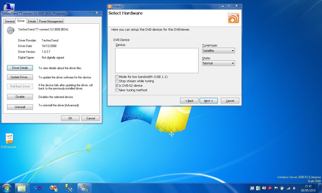

Take a look at the screenshot to quickly understand the problem
TT-connect S2-3600 USB is installed
on a windows 2008 R2 64 Bit
but the DVBViewer (4.2 & also new beta) can not see the device :)

You are not using a complete DVBViewer installation.
Windows Server 2008 R2 has no BDA driver support. You need some files from Windows 7 (and a complete DVBViewer installation).
Search for Windows Server 2008 R2 BDA on the internet.

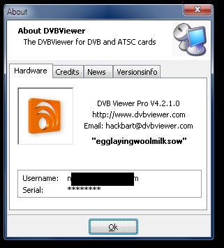

hello this is a complete installation (i put another screenshot)
No its not, I guess you never executed the DVBViewer 4.2.1 .
you obviously guessed wrong, because i did install 4.2.1 before trying the new beta
what makes you think so ?
On your System is no VODSource registered. And many configuration files are missing.
