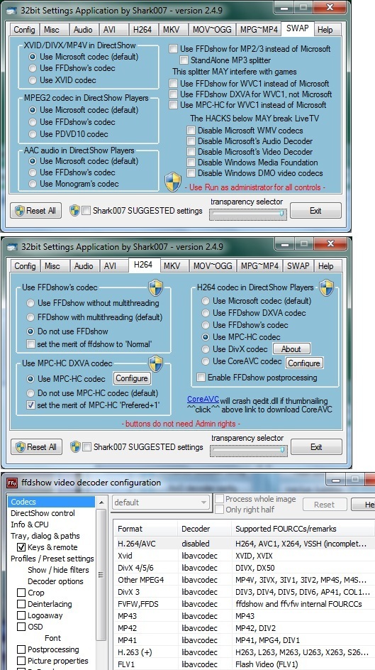

dcafri Posted July 2, 2010 Author Posted July 2, 2010 Hi, I understood that I need to choose the correct codec which will use the GPU rather than the CPU. What I don't know is which codec will do that... I also understood that the ffdshow decoding will not work with the TV. I'm fine with that since the HD TV is already working with the "Video A" options, using "Cyberlink H.264/AVC decoder (TechnoTrend)". I can put the ffdshow confguration as "Video B". I attached the ffdshow configuration which I have in my computer (both 32 & 64 bit application). Quote
dvbrewer Posted July 2, 2010 Posted July 2, 2010 I'm fine with that since the HD TV is already working with the "Video A" options, using "Cyberlink H.264/AVC decoder (TechnoTrend)". That should be fine. I can put the ffdshow configuration as "Video B". I attached the ffdshow configuration which I have in my computer (both 32 & 64 bit application). You'd be better off using MPC as your Video B H.264 decoder as it will use the GPU, standard ffdshow won't (ffdshow DXVA will but MPC is more developed than this currently). Quote
dcafri Posted July 2, 2010 Author Posted July 2, 2010 Well, I thought that what I was doing the last time... I don't have MPC-HC direcly in the VideoB pull-up options, so I selected ffdshow. In the ffdshow I configured it to use the MPC-HC (as you can see in the jpg snapshot I attached before). Is that what you were pointing me to do? If so, It still no good for the mkv movie :-( Quote
dvbrewer Posted July 2, 2010 Posted July 2, 2010 (edited) Well, I thought that what I was doing the last time... I don't have MPC-HC direcly in the VideoB pull-up options, so I selected ffdshow. In the ffdshow I configured it to use the MPC-HC (as you can see in the jpg snapshot I attached before). Is that what you were pointing me to do? If so, It still no good for the mkv movie :-( You can't configure ffdshow to use MPC-HC, your screenshot shows Shark codec options. If your shark settings are still as shown you should be able to select MPC as your Video B H264 decoder. Edited July 2, 2010 by dvbrewer Quote
