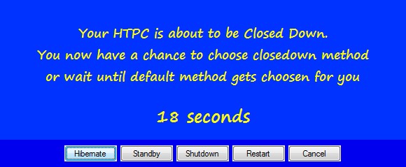

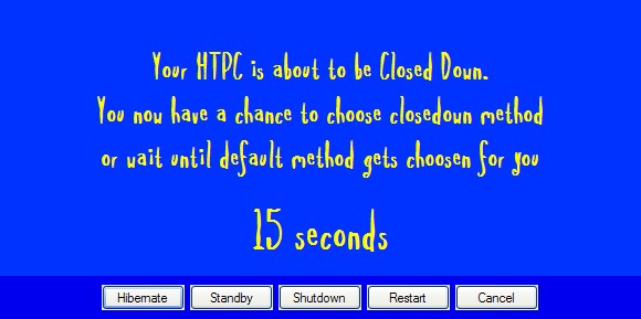

majstang
Hi Folks!
Made some updates on both the Intelligent Hibernation Script and the Intercept Hibernation script.
Hibernationscript:

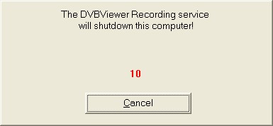

- It is now possible to use Recording Service own native PowerTasks and cancel messagebox. Read the script for instructions on how to enable the RS PowerTask. If using this option the Intercept Hibernation/shutdown script for WindowsXP will not be needed, cuz Recording Service blocks and delays the hibernation/shutdown for you (same principle as the Intercept Hibernation/Shutdown Script). Recording Service own cancel messagebox will only be displayed on WinXP systems. If using Windows 7 use Intercept Shutdown script for Windows 7. That will grant you a chance to cancel hibernate/standby/shutdown...otherwise HTPC just hibernates/shuts down after recording is finished without any warning and you wont be abled to stop it, during times you specify when hibernation/standby/shutdown is allowed.
- Also added Standby and Shutdown option if preferred instead of hibernation for use with the Intercept Hibernation/Shutdown script.

Update Intercept Hibernation/Shutdown script for Windows XP:
- This script now intercepts hibernation/standby/shutdown/restart.
- Removed the countdown timer in wintitle
- Added vast styling possibilities for the msgbox. You can now combine html and javascript with Autohotkey inside the messagbox and pretty much get it to look and do what ever you like.
- Added a javascript countdown timer
- Added handwritten fonts
- More closedown options
A little example on what you are abled to do:
The countdowntimer function in this script needs a little explanation. When msgbox timeouts (countdown timer reaches 0 seconds) this script is configured to:
- If a hibernation/standby is intercepted the default closedownmethod is Hibernate. You can alter this by changing BDefault (ButtonDefault) to what closedown method you like to use. After 20 seconds of countdown this default closedown method will be executed per automatic.
- If a shutdown/restart is intercepted the default closedownmethod is Shutdown when msgbox timeouts.

<div align="Center"><p>
<font color="#FFFB02" face="SpillMilk" size="6"><br><b>
Your HTPC is about to be Closed Down.
<br>
You now have a chance to choose closedown method
<br>
or wait until default method gets choosen for you</b>
</p>
<font face="SpillMilk" size="7"><b>

Options := "Buttons=Hibernate/Standby/Shutdown/Restart/Cancel, HtmW=580, HtmH=250, BDefault=3, DlgBgColor=0xEE0000, DlgTopmost=1, TimeOut=20, Title=System Closedown in 20 seconds, DlgStyle=NoFrame"
;Change BDefault (ButtonDefault) to what closedown method you like to use. After 20 seconds of countdown this default closedown method will be executed per automatic.
;Button 1=Hibernate
;2=Standby
;3=Shutdown (Deafult today)
;4=Restart
;5=Cancel
Sel := HtmDlg( URL, "", Options )

Usage: HtmDlg( URL, hwndOwner, Options, OptionsDelimiter )
Parameters :
URL              - A valid URL supported by Internet Explorer including Res:// and File://
hWndOwner        - Handle to the parent window. If invalid handle or 0 ( zero ) is passed,
                  the dialog will have a taskbar button. Passing "" as a parameter will
                  set 'Progman' the owner, thereby supressing the 'Taskbar Button'.
Options          - A series of 'variable overrides' delimited with character specified in
                  'Optionsdelimiter'. Please refer 'VARIABLE OVERRIDES' below.
OptionsDelimiter - The delimiter used in seperating 'variable overrides'
;  * * *   V A R I A B L E   O V E R R I D E S   * * *
Important Note: leading 4 characters of a variable will be sufficient.
               for eg.: Instead of 'AltReturn=1' you may use 'AltR=1'
DlgXpos         = X coordinate in pixels, relative to screen
                 Dialog is horizontally centered by default
DlgYpos         = Y coordinate in pixels, relative to screen
                 Dialog is vertically centered by default
DlgTopmost      = 1 will set the Dialog 'Always-on-Top'
                 0 is default
DlgDisable      = 1 will disable the Dialog window
                 No default value
                 Caution:
                 Since there is no way to interact, you may opt to TimeOut the Dialog
DlgStyle        = Frame or NoFrame or Border. Leading character is sufficient, like: F-N-B
                 Default is Caption
                 Note on Styles used:
                 Frame   = WS_POPUP | DS_MODALFRAME
                 NoFrame = WS_POPUP | DS_SETFONT
                 Border  = WS_POPUP | DS_SETFONT | WS_BORDER
                 Caption = WS_POPUP | DS_MODALFRAME | WS_CAPTION | WS_SYSMENU
                 WS_DISABLED is additionally set when DlgDisable=1
DlgNoActivate   = 1 will Show the Dialog without activating it
                 0 is default
DlgBgColor      = ColorRef.  eg: 0x0000FF is Red / Invalid ColorRef will result in Black.
DlgWait         = 1 will delay Dialog from being shown - until HTM is fully loaded
Sleep           = MilliSeconds ( Will be used just before Dialog is shown )
                 Default value is -1, 'No sleep'
Title           = Captionbar Text
                 Default is A_ScriptName
AltReturn       = 1 will return Button-text
                 0 is default and Button-instance will be returned
TimeOut         = Seconds
                 No default value
                 Note: A_LastError will be true when a TimeOut occurs
ClickClose      = 1
                 Default value is 0
                 Note:
                 Mouse L-Click on window's unoccupied clientarea' will close the dialog
                 Tip: Use following to simulate a unobtrusive message ( like TrayTip )
                 DlgTopmost=1, HtmD=1, DlgNA=1, DlgStyle=Border, BHei=0, BSpV=0, Clic=1
LeftMargin      = Spacing in Pixels ( on the left/right sides of WebControl )
                 Default value is 0
TopMargin       = Spacing in Pixels ( above the WebControl )
                 Default value is 0
FonName           ( Not implemented yet )
                 Default is 'MS Shell Dlg' and equivalent
FonSize         = Pointsize ( text size of Button-labels - restricted to 8,10,12,14 )
                 Default value is 8
HtmClientEdge   = 1 to set WS_EX_CLIENTEDGE
                 Default value is 0
HtmDisable      = 1 to disable
                 Default value is 0
HtmWidth        = Width of WebControl in Pixels
                 Default value is 240
HtmHeight       = Height of WebControl in pixels
                 Default value is 140
HtmFocus        = 1 will activate the dialog and WebControl will have input focus
                 Default value is 0
                 Note: DlgNoActivate option will lose effect.
                       For best result, use this option along with DlgWait=1
Buttons         = Button labels seperated with "/"  eg: Buttons=Yes/No/Cancel
                 Default Button is "OK"
BDefault        = Instance of Default Button. eg: To make 3rd Button default, use BDef=3
                 Default forced value is 1
BEscape         = Instance of Button to return when dialog is closed or {Esc} is pressed
                 Default is 0
BWidth          = Button Width in Pixels
                 Default Value is 75
BHeight         = Button Height in Pixels
                 Default value is 23
BSpHorizontal   = Pixels ( affects the spacing on the sides of a button )
BSpVertical     = Pixels ( affects the spacing above/below a button )
BAlign          = 0 or 1 or 2  ( for Left, Center, Right alignment of buttons )
                 Default is 1
BNoTheme        = 1 will remove theme from buttons ( XP & greater )
                 No default value
BSFlat          = 1 will flatten the button by removing the 3D edge - requires BNoTheme=1
                 No default value

        WindowsXP users only!!! If using the "Intercept Hibernation/shutdown script" you will have the opportunity to cancel System Closedown through a messagbox and
        simultainously be presented with several options (Hibernate, Standby, Shutdown, Restart or Cancel ) what to do next.

This line in the Interceptscript for Windows 7 dictates how the messagebox should behave:
Options := "Buttons=Hibernate/Standby/Shutdown/Restart/Cancel, HtmW=580, HtmH=200, BDefault=1, DlgBgColor=0xEE0000, DlgTopmost=1, TimeOut=20, Title=System Closedown in 20 seconds, DlgStyle=NoFrame"
DlgTopmost=1 means the messagebox is set to be Always-On-Top.
I can see two possible causes for your issue:
1. WMC is also set as Always-On-Top and have superiority. In such a case I would play around with the WMC settings.
2. When you copy this script from this thread, make sure the whole Options line stays on one line with no rowbreaks. I did notice earlier when I did copy the script myself from this forum and pasted it into a notepad document the optionsline looked like this:
The criterias after the rowbreak will not work, but in such a case you will get a warning during startup of this exe (if you have it in autostart).

RunBeforeShutdown:
SetTimer, RunBeforeShutdown, Off
SendInput, {ENTER}
Sleep, 1000
#SingleInstance, Force
SetWorkingDir %A_ScriptDir%
FileDelete, demo.htm
FileAppend,
<html>
<body style="overflow:hidden">
<body bgcolor="#0033FF" leftmargin="1" topmargin="1">
<font color="#FFFB02" face="Segoe Print" size="4"><br><b>
<br>
<br>
</p>
<font face="Segoe Print" size="5"><b>
<script type="text/javascript">
var countDownInterval=20;
var countDownTime=countDownInterval+1;
function countDown(){
countDownTime--;
if (countDownTime <=0){
countDownTime=countDownInterval;
clearTimeout(counter);
//window.location="";
return
if (document.getElementById) //else if NS6+
document.getElementById("countDownText").innerHTML=countDownTime+" ";
else if (document.layers){ //CHANGE TEXT BELOW TO YOUR OWN
document.c_reload.document.c_reload2.document.write('<b id="countDownText">'+countDownTime+' </b> seconds')
document.c_reload.document.c_reload2.document.close()
counter=setTimeout("countDown()", 1000);
function startit(){
if (document.getElementById) //CHANGE TEXT BELOW TO YOUR OWN
countDown()
startit()
else
window.onload=startit
clearTimeout ( countDownTime );
</script>
</font></b>
</div>
</body>
</html>
, demo.htm
URL=file:///%A_ScriptDir%\demo.htm
if (Sel = 1)
  DllCall("PowrProf\SetSuspendState", "int", 1, "int", 0, "int", 0)
  Return
else if (Sel = 2)
  DllCall("PowrProf\SetSuspendState", "int", 0, "int", 0, "int", 0)
  Return
else if (Sel = 3)
  Process, Close, DVBViewer.exe
  Shutdown, 1
  ExitApp
  Return
else if (Sel = 4)
  Shutdown, 2
  ExitApp
  Return
else if (Sel = 5)
  hibernate = 0
  Return
DllCall("ShutdownBlockReasonDestroy","Uint",hwnd)
Return                                                 ; // end of auto-execute section //
RunBeforeShutdown2:
SetTimer, RunBeforeShutdown2, Off
FileAppend,
<html>
<br>
<br>
</p>
countDownTime--;
return
function startit(){
countDown()
startit()
else
</script>
</font></b>
</div>
</body>
</html>
, demo.htm
if (Sel = 1)
  Return
else if (Sel = 2)
  Return
else if (Sel = 3)
  Shutdown, 1
  ExitApp
  Return
else if (Sel = 4)
  Shutdown, 2
  ExitApp
  Return
else if (Sel = 5)
  hibernate = 0
  Return

        If you prefer some other default System Closedown method than Hibernate, activate the one you prefer by removing semicolon for choosen PowerTask below and remember to
        inactivate the DllCall for Hibernation by inserting a semicolon in front of that codeline.

        Codelines below can be used to activate Rec.Service native PowerTASKs. WinXP users will get the RS messagebox which allows you to abort shutdown within 10 seconds.
        If using this option the "Intercept Hibernation/shutdown script" will not be needed (WinXP only). Activate by removing semicolon for Task of choice below and remember to
        inactivate the DllCall above by inserting a semicolon in front of that codeline. Don't forget to fill in your username and password in the URL otherwise it won't work.

Hey majstang. I have adapted your intelligent hibernation script to my specific needs (using standby, chrome), and it works great.
But the Windows 7 intercept script doesnt seem to work. I tested by compiling it and making sure it was running in memory, then executing the standby script - the machine immediately entered standby.
Any ideas (Im on 7 Ultimate x64)?
Yes, the cause for that is you seem to be using the intelligent hibernation script from post 27 together with the interceptionscript for Windows 7 from post 26. You see the interceptionscript are not abled to intercept anything else than shutdown and the 0x5555 message. Standby and hibernation calls can not be blocked/intercepted. If configuring the intelligent hibernationscript making a standby call as RS after recording task, the interceptionscript will unconditional miss it. Therefor the intelligent hibernationscript for Windows 7 (post 26) must be configured to make the shutdown call or send the 0x5555 message (which also will be intercepted and fire up the msgbox). Unfortunately RS uses forcelful shutdown on Win7 which can not be intercepted/blocked. That is why I had to add the named pipe solution which makes the shutdown call non-forceful and therefor interceptable for the interceptionscript (it also allows sending messages between the service session where RS runs to the desktop users session where the interceptionscript runs). That is why scripts in post 26 should be used as a unit. If you wanna have processes (Chrome) as main variable to cancel standby/hibernation in the Adapted Intelligent Hibernationscript for Windows 7 (it uses time as main variable today) I can easily adapt it for you. Let me know if so. If you wanna use standby as the default closedown method the interceptionscript will also need some tweaks.
Thus for your personal preferences I recommend you to mapp your remotecontrol to NOT use shutdown or standby nor hibernation. Mapp it to the intelligent hibernationscript instead. In that way the shutdown command will never be sent if not all RS conditions are met, so it is practically impossible to manage to standby the system while for example a recording is going on. Its neat to have the intelligent hibernation script to gather some intelligence about the current conditions of RS (even executed from outside of the Windows Services user session) before making any attempts to shutdowm-->standby the system.

Intercept Shutdown script for Windows 7 64-bit
#NoTrayIcon
#Persistent
;While !DllCall("WaitNamedPipe","Str","\\.\pipe\InterceptShutdown","UInt",0xffffffff)
;Sleep, 100
;Run % """" A_AhkPath """ \\.\pipe\InterceptShutdown"
Gui,+LastFound
hwnd:=WinExist()
DllCall("ShutdownBlockReasonCreate","Uint",hwnd,"Str",A_ScriptFullPath "is still running")
DllCall("kernel32.dll\SetProcessShutdownParameters", UInt, 0x4FF, UInt, 0)
OnMessage(0x11, "WM_QUERYENDSESSION")
OnMessage(0x5555, "RunBeforeShutdown2")
Return
WM_QUERYENDSESSION(wParam, lParam)
   static sdtry = 0
   ENDSESSION_Logoff = 0x80000000
   If (lParam & ENDSESSION_Logoff) ; User is logging off.
     EventType = Logoff
   Else     ; System is either shutting down or restarting. and
     EventType = Shutdown
   If (EventType = "Shutdown" and sdtry = 0)
      SetTimer, RunBeforeShutdown, On
      Return false ; Tell the OS to Abort the Shutdown/Logoff.
   Else If (EventType = "Shutdown" and sdtry = 1)
     Return true
RunBeforeShutdown2(wParam, lParam, msg)
   SetTimer, RunBeforeShutdown2, On
   Return true
RunBeforeShutdown:
Sleep, 200
SendInput, {ENTER}
Sleep, 1000
FileAppend,
<html>
<br>
<br>
</p>
countDownTime--;
return
function startit(){
countDown()
startit()
else
</script>
</font></b>
</div>
</body>
</html>
, demo.htm
Options := "Buttons=Hibernate/Standby/Shutdown/Restart/Cancel, HtmW=650, HtmH=250, BDefault=1, DlgBgColor=0xEE0000, DlgTopmost=1, TimeOut=20, Title=System Closedown in 20 seconds, DlgStyle=NoFrame"
FileAppend,
<html>
<br>
<br>
</p>
countDownTime--;
return
function startit(){
countDown()
startit()
else
</script>
</font></b>
</div>
</body>
</html>
, demo.htm
