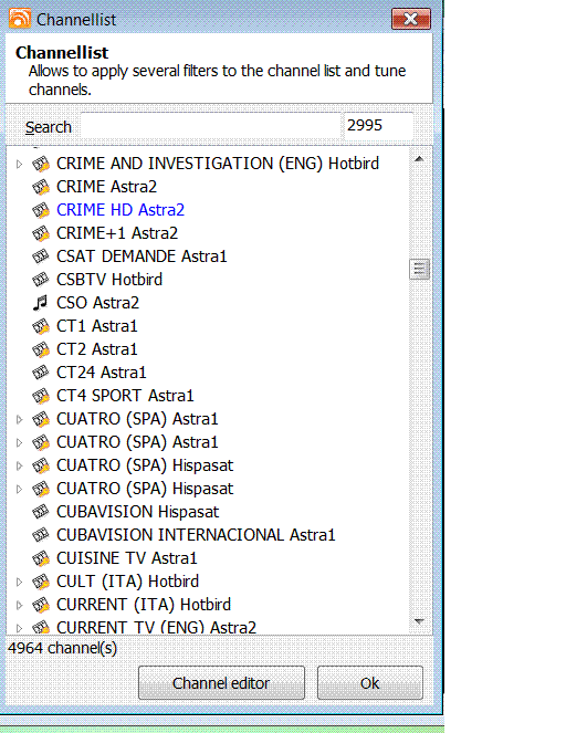

I found a way to do this, similar to my 'solution' in the other topic 'Option to change case of channel names'.
Presumably there is a more efficient method, which would be especially important if you have lots of different satellites. Luckily I only have four.
I have little understanding of regular expressions, and I suspect that will always be the case. I only managed to find this and the other solution by using this page :
http://www.regular-expressions.info/completelines.html
and using the Help in Open Office Writer.
So, to do this ...
Export each satellite in the channel list as separate .ini files.
Do all of the following for each .ini file. ie for me, four .ini files to do. (Astra1, Astra2, Hispasat and Hotbird.)
Load it into Open Office Writer. When prompted for 'ASCII Filter Options' I hit 'ok' to the offered defaults.
Go to 'Edit' 'Find & Replace' and then click on 'More Options'. Select 'Regular expressions'. The 'Search for' expression is:
^.*Name.*$
Hit 'Find All' and that will find and select every 'Name=' line in full.
In the 'Replace With' box type, for example:
& Hotbird
Hit 'Replace All'. All the 'Name=' lines will have a space added to the end and then 'Hotbird'.
Close the 'Find & Replace' menu.
On then saving the .ini I was prompted / warned about formating. I chose 'Keep current format'. Exit Writer.
Clear the whole channel list in DVBViewer and import the .ini we just saved.
The result is better than nothing (for me) and looks like the attached screen grab. (All the channel names are in upper case because I had already performed the process described in the topic 'Option to change case of channel names'.
