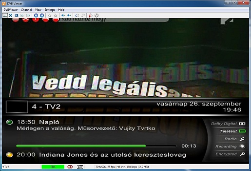

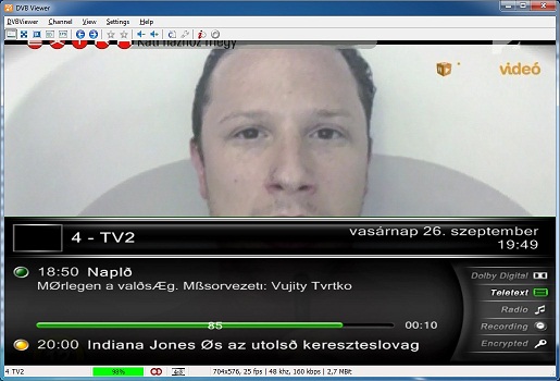

I have invalid characters in EPG, see the two screenshots:
Characters are correct in 4.2.1 version, but not in 4.5 RC1 (and they are incorrect in 4.3.x beta versions as well). The problem is with the special hungarian characters with accents (áéőúöüűóíÉÁŐÚŰÖÜÓÍ).
I have two tuners: Avermedia Volar HX (DVB-T) and Technisat Cablestar Combo HD CI (DVB-T and DVB-C). EPG character problem exists only with DVB-C, DVB-T EPG is correct with both tuners. (My cable provider may be using different EPG coding?)
It's not an OSD problem, since EPG text is displayed incorrectly wherever it appears (e.g. in EPG window). Teletext and channel names are ok.

Hungarian characters to be fixed (what is displayed now = what it should be):
Ŧ = í
Ø = é
Æ = á
ı = ő
œ = ú
ß = ű
ij = ö
þ = ü
ð = ó
♪ = Ő
Û = Ű
¬ = Ö
⅛ = Ü
© = Ó
Characters Í, É, Á, Ú seems to be correct.
