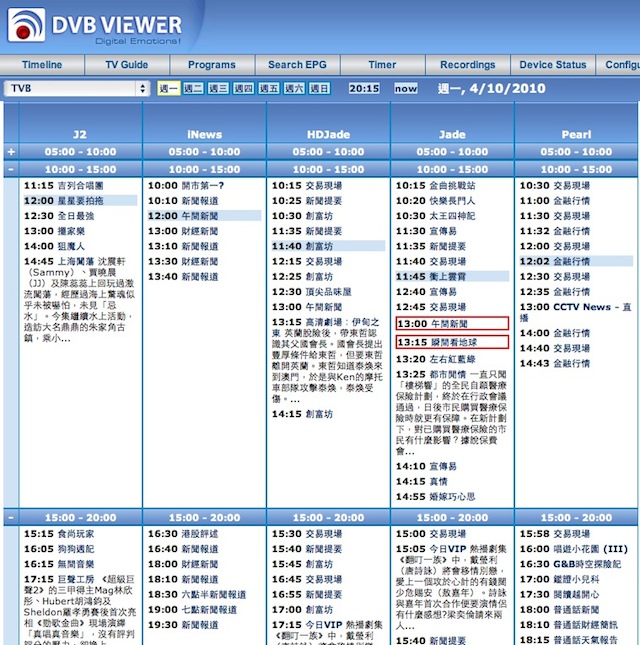

Paul Posted October 4, 2010 Posted October 4, 2010 I suspect that one of the channel in HK broadcasting empty EPG data every morning till afternoon, so when RS is going to update the EPG data on scheduled time or execute timer recording, the EPG data of that channel will be erased. Is it possible for RS not to overwrite the existing EPG data if received EPG data is empty?
Paul Posted October 4, 2010 Author Posted October 4, 2010 Keep trying Tasks->Start EPG Scan again and again, the EPG data of that channel is back at 12:15pm

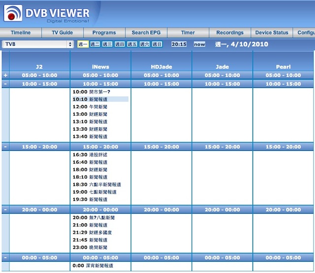

Paul Posted October 5, 2010 Author Posted October 5, 2010 I prepared three epg.dat collected at different time for you to take a look. epg.dat was collected on yesterday evening. http://www.umpcfever.com/files/epg.dat epg1.dat & epg2.dat were collected in this morning. You can see the file size are reduced. At that moment, the EPG data under TVB channels is almost empty. http://www.umpcfever.com/files/epg1.dat http://www.umpcfever.com/files/epg2.dat epg3.dat was collected this afternoon. You can see the file size become bigger, and most of the EPG data is back, http://www.umpcfever.com/files/epg3.dat
Paul Posted November 28, 2010 Author Posted November 28, 2010 I solved my empty EPG problem by deleted epg.dat everytime before perform Start EPG Scan. I also disabled EPG update (NoEPG=1) by default and only enable it for a few minutes before Start EPG Scan.
