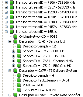

Griga Posted December 5, 2010 Posted December 5, 2010 Thanks. As expected there is a DVB-T2 delivery system descriptor in the NIT (see sceenshot), enabling the identification of such transponders. It doesn't contain much information, not even the centre frequency - could be more, but the rest is optional. TransEdit 3.6 doesn't know how to decode it, so you will only see an Extension Descriptor with DescriptorTagExtension = 0x04 there. I've recently added the T2 descriptor in the parser, and the next release will be able to display the content. Maybe I will upload a TransEdit test version with some DVB-T2 handling within the next days. So please stay tuned... Quote
