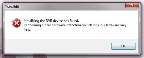

hello, today i played with some feeds, and i used transedit (latest 3.6.1) for searching for it
sometimes transedit worked correctly but sometimes gived to me a "not devices present" and the sat card stopped to works until a pc reboot
it happened many times with some search (eg: some search ok and the next one i had the error and the card hanghed)
after the card "lock" no chance to use it, with or without the recording service and as well using other softwares

just tested a new scan, recording service started (without any schedule or client active)
transedit: updated 13e
all fine, but at the "scan all" i had the not found hw error, after this no chance stopping/restarting the recording service or trying DVBViewer
in transedit hw setup i have just "dvb-s2" and "use internal network provider filter" actived

If there is no device available because DVBViewer or rs keeps them busy, you should a get a more specific message from transedit.
no, is another one,
and this time hanghed during a simple satellite update (with rs active)
but the warning message appeared when i tried to scan a transponder (after that update)

no, is another one,

after a sat update appears always that warning (with rs active)
forgot to say: after that warning i have always it, as well if i re-execute transedit with or without the hardware "detect devices"
edit: this time for have transedit (or DVBViewer) back to working was enough to stop then restart rs, but yeaterday many times doesn't helped
