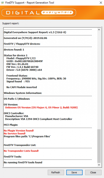

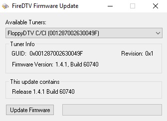

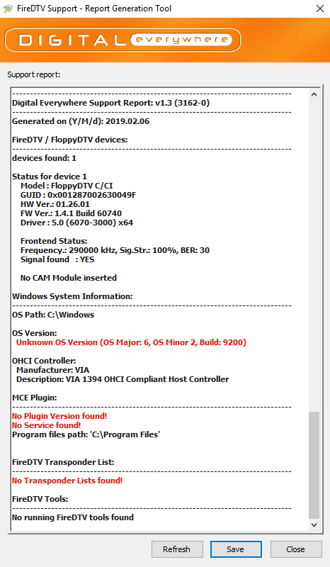

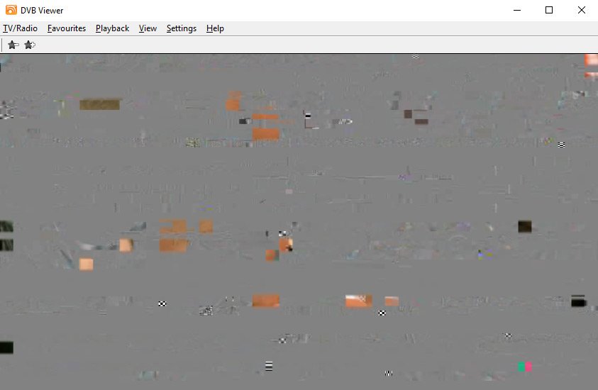

Hey guys,
I've been happily using a FloppyDTV C with DVBViewer for ages and it's been working mainly really well but every now and then when I change the channel, the picture and the audio goes crazy and I need to restart the DVBViewer. I just switched to completely different computer and the same problem happens, so it's either a bad unit or some driver / firmware issue?
Attached is a screenshot of DVBViewer when it goes crazy, and my hardware information. I tried updating the firmware using the links above, but even the 1.54 updater is offering me the same 1.4.1 firmware?
I'm running a fresh install of Windows 10 64bit and I only installed the x64 DBA driver from FireDTV-5.7 drivers. I have not messed with the IEEE1394 host controller settings.
Anyone still using firedtv today in win10?
