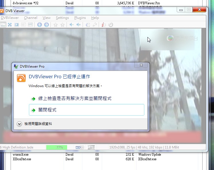

While watching HD TV with DVBViewer v4.6.0.1, the memory usage starting from 144,xxxK and keeps growing to 3,645,736K within few minutes then it crashed.
I'm using Windows 7 64-bits
Try using a different HD Filter. Mine does that when using DivX. Cyberlink PowerDVD10 Filter works perfect for me,also PowerDVD 8/9 H264 are good.
