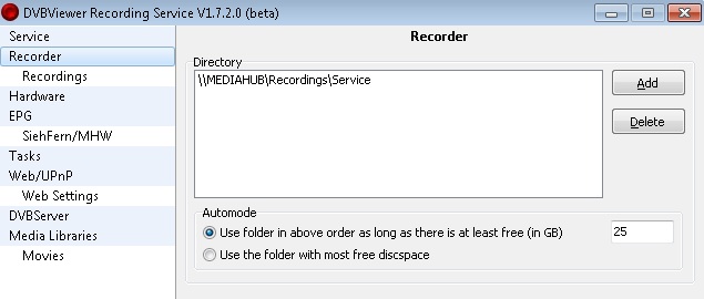

How have you configured Recorder on the service PC?
The green is the right way, and red the wrong.
This is my config, so it should be correct
/Peter
