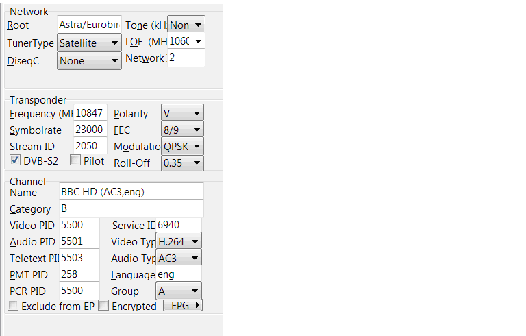

I'm having a problem locking on to the BBC channels (Hauppauge NOVA S2-HD).
Can anybody advise whether all of my settings are correct?
Your LOF settings seem to be wrong. 10847 MHz is low band (all frequencies up to 11700 MHz), so the LOF should be 9750, not 10600 MHz.

The only difference between your pic and my working settings is that my LOF is set to 9750, try that.

Thanks all. I've corrected by LOF setting and hopefully this will sort it out.

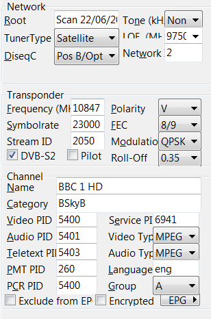

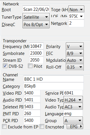

Hi guys - long time lurker here :)
I've just come back from a 3 week holiday and noticed that my BBC One HD and BBC HD have stopped working.
I have tried a channel re-scan (using the settings on the screenie below) which fails to locate any of the BBC HD channels. So I tried to manually add BBC One HD, again to no avail. Can someone advise to my why I still can't see the channel? I can confirm that my ITV1 HD and other terrestrial channels are working fine. I have a TBS QBox DVB-S2 tuner.
Many thanks :)
Don.

Oops it didn't look like images attached. Take two...

Video Type = H.264
Audio Type = AC3

I tried those settings too but unfortunately, no luck.
Any other ideas on what else I can try?

Did you make the required changes using TransEdit as mentioned by Griga earlier in this thread?

My modulation is set to QPSK (yours is Auto), not sure if it makes any difference.
