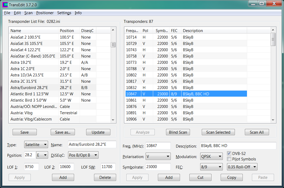

Hey Frank,
Unfortunately even with the QPSK setting, it still can't see the channel. I've attached a screenshot of my TransEdit settings.
My device is a TBS QBox DVB-S2 USB2 device.
http://www.tbsdtv.com/english/product/images/qbox_s2_vs_qbox_3.jpg
I've just noticed in the image comparison above that on my version of the QBox, that the DVB-S2 on QPSK only supports symbol rates 20-30Msps. Is that likely to make a difference? It would seem weird considering I was receiving the BBC1HD and BBCHD channels fine before the switch.

Hey Frank,
TransEdit can't initialise my DVB device so it doesn't even allow a preview.
That said, I finally managed to get it working. I turned off the DiseqC (set the option to 'None') and then did a full channel scan, and voila the BBC HD channels appeared and are work perfectly fine! Very strange. I was just playing around with various permutations and that seemed to do the trick. The weird thing is that the HD channel appears in a blue font in the channel list. Not sure what that is.
Thanks for all who helped me try to find a solution.
Don.
Edited by donkeycart22
Hey donkeycart22,
the blue font in TRANSEDIT says, that it is DVB S2.

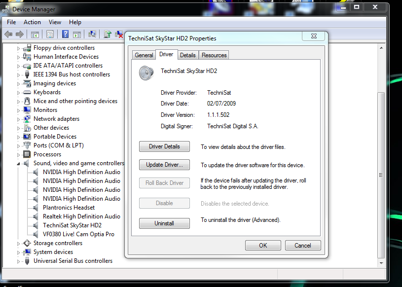

Hi, I'm having the same kind of issue with my Technisat SkyStar HD2 PCI card.Since the BBC move to the S2 modulation mode on Satellite: Astra 2D tp.50
Frequency: 10,847MHz (vertical polarity)
Modulation: DVB-S2, QPSK
Symbol Rate: 23.0
FEC: 8/9
I have been unable to receive any signal from that transponder.I have been talking with TechniSat's technical support who I must say have been very helpful but have drawn a blank as to why the card will not receive anything from this transponder.I have a dm800hd box running from the same LNB and this works fine so I know its not the LNB.just wanted to know if anyone had the same issue really..
Thing I have tried so far
1.Tested and substituted LNB
2.added updated file to transponders folder
3.scanned 10846 and 10848 just encase the LNB's oscillator was out
4.used new version of the drivers for the card
one other thing to add is that I'm sure the card is receiving other S2 transmissions as I can get all MTVNHD etc
Thanks in advance for any help
