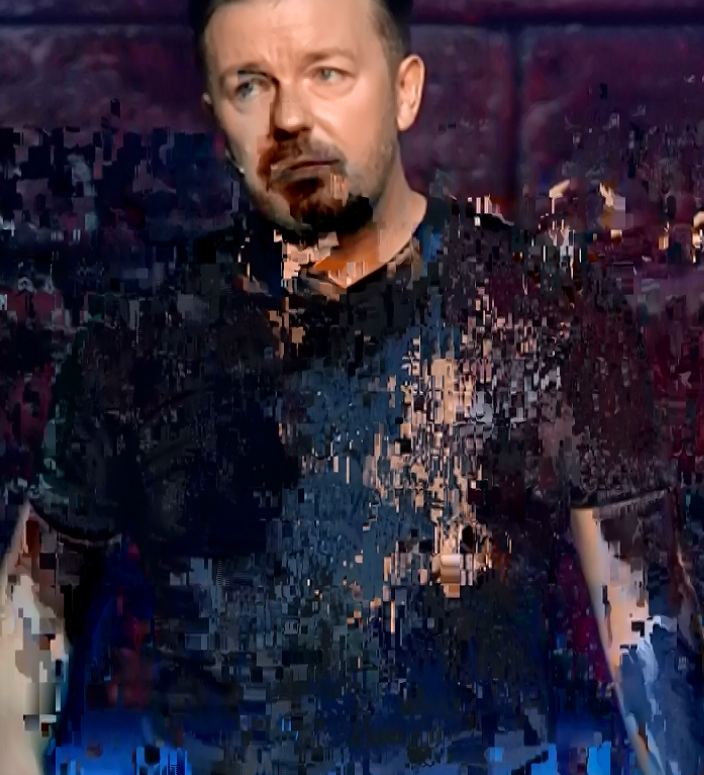

Since the change from DVB-S to DVB-S2 of BBC ONE HD and Channel 4 HD I have not been able to view anything decently on these channels. Aretefacts are main problems. Have been messing around with most of the codecs and renderers that is possible. Currently with PowerDVD 11.
Is there any general advice to all DVB-s2 users? For example is the solution to upgrade to a different DVB-S2 card ? Use a different renderer etc.
This is driving me nuts as previous BBC HD on DVB-S was quite decent but since going on to DVB-S2 it is pants.

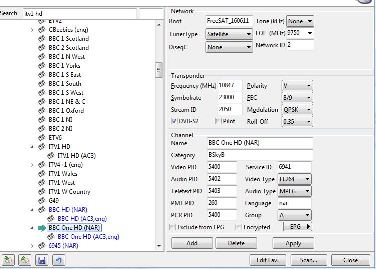

I enclose support.zip
Anyone in the UK with a similar problem ? or a solution would be great ....any comments appreciated.
attachment=28640:options.JPG].

I have tried PowerDVD11 (via Sharks codecs pack) and similar issues. DXVA was selected ( I have tried all 3 options on the codec SW HAM and DXVA) but similar results. It is somewhat bizarre that ITV HD (DVB-S) at a higher bit rate copes very well but DVB-S2 seem not to. Both my CPU and GPU are hardly been taxed speed wise as both are toggling at about 20% max. BLU Ray movies play faultlessly at full screen. My ATI CCC is 11.6.
Have tried DVB Dream and ProgDVB but gone similar issues. Funny enough ffdshow copes bit better (on that codec you can specify postprocessing), but that keeps freezing.

Have removed ccc 11.6 and now with ccc 11.4..Still artefacts. Also tried coreavc codecs but no chnage.

After this working flawlessly for a whole day the following day the artefacts have re-appeared.

Result , DVB-S2 channels suffer from artefacts just as before - AMD claim to have fixed this.
When I turn off DVXA ( from View--->filters-->PowerDVD11) and set the filter to SW, the picture has no artefacts at all but it keeps freezing every few soconds.
I have tried many other H264 decoders and exactly same results.
