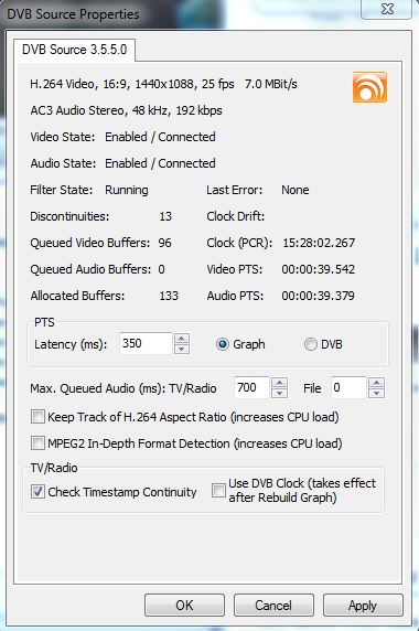

Using the Blackgold DVB-T2 card which is working off the same terrestial aerial that my old Pinnacle USB stick was connected to, it shows signal as between 4% and 8 %..... the picture quality is excellent so I guess it is being reported incorrectly, I'm not too far from the Crystal Palace transmitter. This used to be reported as about 85% -90% before by the Pinnacle USB stick which is now not connected any longer.

You could ignore the signal information which is provided by the device. The percentage value differs from device to device and is (at least if you do not have a expensive hardware analyzer) not really reliable. To determine the signal quality try to have a look into the property page of the dvbsource filter.
Thanks....here is the DVBSource view but cannot see any signal properties, it is no big deal anyway.

Without discontinuties the picture quality is at 100% :)
Thanks for the explanation. :bye:
so on DVB-s2 where I am getting lots of discontinuities (signal at 94%) and sometimes I get artefacts, is that likely to be dropouts of the signal from freeSAT DVB-S2 transmission. I get no discontinuities on ITV HD (but that is DVB-s).
