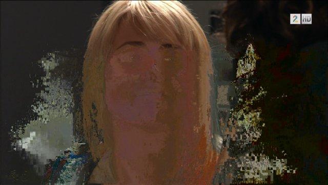

Knut Posted September 20, 2011 Posted September 20, 2011 Hi, At the moment i have this cards: Grapic/ video card: HIS Radeon HD 5450 512MB DDR3 Tv/Turner Card: TerraTec Cinergy C PCI& CI, HD-sup And are running Windows 7 64bit But i have som interruption om my channels so i want to buy new TV Card and video card, and see if it getting better. Size i have cabet TV i use DVB-C(Cable-TV), with CI internal module. I would like to have a card with more than one turner to. What are the best/hottest cards to buy, who work good with windows 7 64bit?? Pize doesent matter, i want this to run good :-) Im useing DVBViewer and it looks like its running very good. HD channels to. But somethimes i got interruption. It not so often, it can be a minutte or so between the interruption. Quote

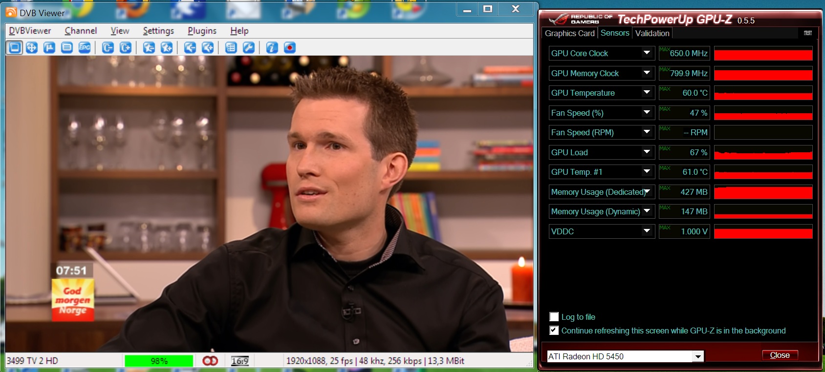

Knut Posted September 22, 2011 Author Posted September 22, 2011 Hi, Here is GPU-Z utility while watching HD. Highest readings. I post current under. Can you see anything who should be different?? Quote
QBox User Posted September 22, 2011 Posted September 22, 2011 (edited) That loading is similar to my own, though it's mostly 50% or lower on a 9 Mbps stream - about the fastest I can get from satellite. My GPU is a bit slower than yours, only 450Hz maximum. I watch or record HD channels quite a lot and while I often see thse picture issues, they are not present all the time. While doing that test this morning, I did see some "glitches" on the picture. When I went back to the channel later, after checking the codec settings, it was clear again. I had also moved my (motorised) satellite dish, so it's possible I hadn't been receiving the strongest signal. It's a nuisance that DVBViewer Pro doesn't provide Signal Quality. It's interesting that the GE application, based on an earlier Pro version, had a much lower GPU load, even with the same EVR/codec combination, and a higher "Video engine load". I don't have another H264 video codec to compare with the Microsoft one, but it usually performs OK for me. I wouldn't expect a wired Ethernet adaptor to cause interference, only radio devices, but it's a difficult area to investigate. Switching things off is the only practical way to search. If the case isn't grounded, then an external interference source could be a problem. You could try switching off or removing any obvious transmitters such as cell- or DECT phones - these transmit periodically to their base stations. Edited September 22, 2011 by QBox User Quote
