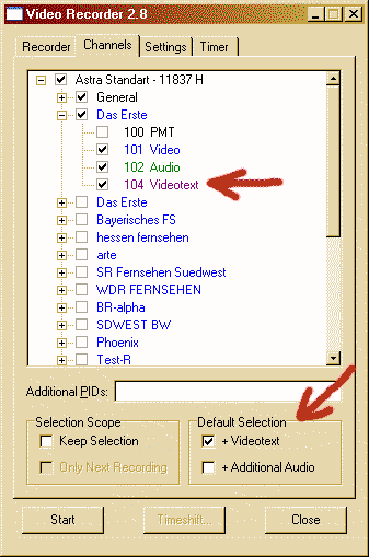

You can do this on the simple way.
Use VRPlugin. And you can demux it with ProjectX.
Simply let the DVBViewer display the subtitles while recording as MPG. You'll get a an additional SUB file. When you play the MPG with the DVBViewer, and it finds the according SUB file, it will display the content.

..well, I didn't knew that this was possible :) How about routing the ttx_es of the ts_file to the teletext decoder when playing back the ts?
Well, the MS file sourcefilter doesn't support something like that. Neither does the Elecard Demuxer. It could be done in the TSPlayer, however, since it doesn't use the standard DirectShow file handling.
