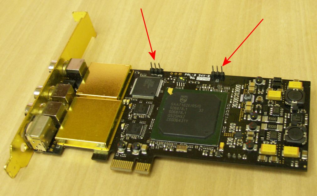

SABBA2 Posted February 23, 2012 Posted February 23, 2012 Hi As a topic mi BlackGold BGT3540 don't work with VHF frequences UHF frequences works very well! Which is the problem? What are the two 3 pin jumper over the board? Can be an hardware problem of BGT3540? Do you think if i buy newest model i'll give the same problem? I have a USB-DVBT key and it works on VHF frequence :-/ Someone please help me! Thanks! Quote

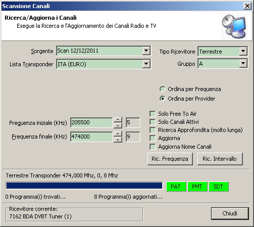

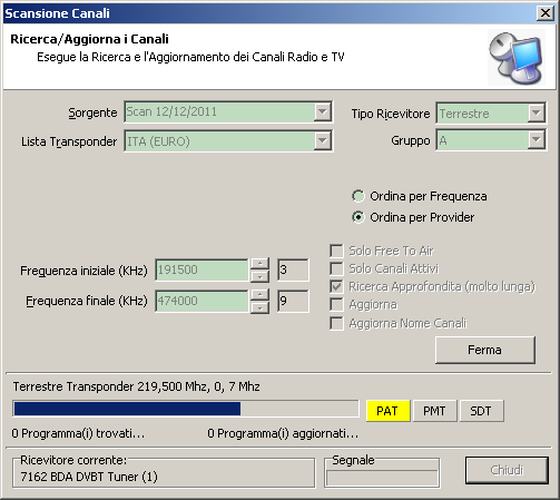

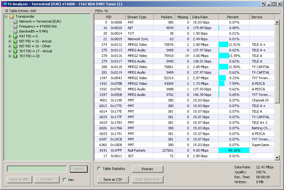

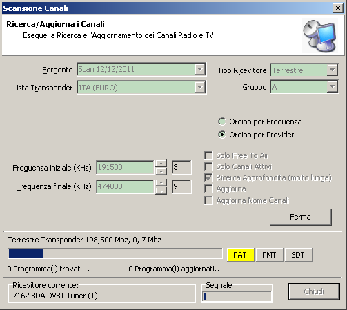

SABBA2 Posted February 23, 2012 Author Posted February 23, 2012 I don't need analogue or S_Video input I need DVB-T channel on VHF frequences I mean VHF = CH.5-12 = 177.500-226.500 KHz See picture: What mean PAT PMT SDT? On VHF they don't be green, only PAT yellow 474.000 KHz works ok Quote

Gioxy Posted February 27, 2012 Posted February 27, 2012 Hi SABBA2, no BlackGold here but you can try to analyze those transponders with "TransEdit" (you can download it from Member's Area) to check how good is the signal reception with the card and with the DVBT key: if they look different despite you use the same cable to feed them, then the BlackGold tuner is too short in sensivity for VHF... Quote
SABBA2 Posted February 27, 2012 Author Posted February 27, 2012 Signal is good, my usb pen can receive VHF frequences BlackGold is a good board So i think a hardware problem I don't know what are the 2 two 3 pin jumper Maybe i should trye to close one of it? I'm thinking to buy BlackGold 3620 the new series Tonight if i have time i'll trye TransEdit, thanks Any other ideas? Quote
Gioxy Posted February 27, 2012 Posted February 27, 2012 AFAIK it mean that do there is some signal, but it cannot be read correctly, e.g. because of weak signal... Different sensivity/ability to deal with dirty signal are normal; I buyed ~5 years ago a Pinnacle DVB-T USB key that has a good overall sensivity, but is pretty "deaf" below 500MHz even with 100% quality signal: it can't tune at all (red "PAT") the RAI Mux on CH 23. Before you ask: yes I've already returned the Pinnacle for a new one (some model) and the result is the exactly the same... Quote
Gioxy Posted February 27, 2012 Posted February 27, 2012 About the pins, Google is our friend: "2 x S-video auxiliary inputs, 1 via rear panel mini DIN socket and the other via an internal pin header, are provided to enable viewing from external video sources, or to enable the digitisation of old analogue TV recordings or home movies for storage or archiving to hard drive or DVD." Quote
SABBA2 Posted February 27, 2012 Author Posted February 27, 2012 About the pins, Google is our friend: "2 x S-video auxiliary inputs, 1 via rear panel mini DIN socket and the other via an internal pin header, are provided to enable viewing from external video sources, or to enable the digitisation of old analogue TV recordings or home movies for storage or archiving to hard drive or DVD." I make several search on google but found nothing! And i found no pdf manual :/ THX Quote
SABBA2 Posted February 27, 2012 Author Posted February 27, 2012 AFAIK it mean that do there is some signal, but it cannot be read correctly, e.g. because of weak signal... Different sensivity/ability to deal with dirty signal are normal; I buyed ~5 years ago a Pinnacle DVB-T USB key that has a good overall sensivity, but is pretty "deaf" below 500MHz even with 100% quality signal: it can't tune at all (red "PAT") the RAI Mux on CH 23. Before you ask: yes I've already returned the Pinnacle for a new one (some model) and the result is the exactly the same... Do you live in italy? So, can i do? I'm thinking to buy BlackGold 3620 the new series It work on DVB-T2 standard Can it be a good idea? Or buy what? Or change kind of antenna? Quote
SABBA2 Posted February 27, 2012 Author Posted February 27, 2012 About the pins, Google is our friend: "2 x S-video auxiliary inputs, 1 via rear panel mini DIN socket and the other via an internal pin header, are provided to enable viewing from external video sources, or to enable the digitisation of old analogue TV recordings or home movies for storage or archiving to hard drive or DVD." Wait a moment. One is like you say. S-video auxiliary inputs an internal pin header And the other one? Quote

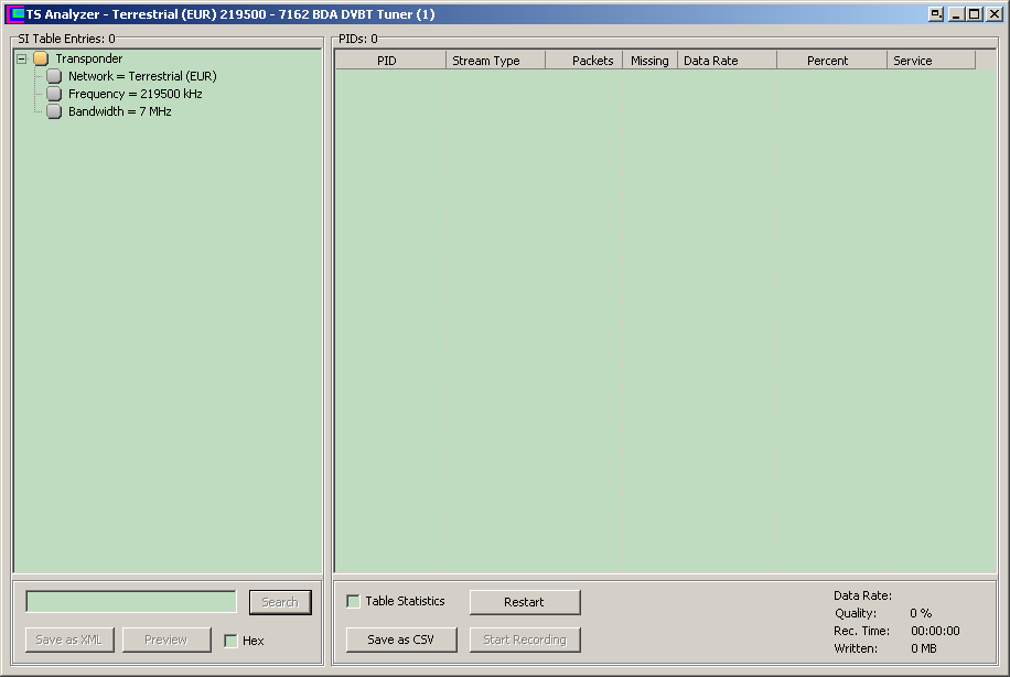

SABBA2 Posted February 28, 2012 Author Posted February 28, 2012 I buy BlackGold BGT3540 on ebay, so i have no manual I trye TransEdit, it work on UHF frequences, but nothing on VHF I trye to change some senttings, but nothing There is something i must to do? thanks for help Quote
Gioxy Posted February 28, 2012 Posted February 28, 2012 There is something i must to do?Yes, please: attach the very same cable you use for the DVB-T key to the BlackGold and post here a copy of TransEdit analysis window on a frequency that do work with the DVB-T Key... Anyway, if it show nothing at all then IMHO you have to consider the reply QBox gave you: I suggest you contact the manufacturer for confirmation of the card's capability. It was designed for the UK market, and there's no VHF TV in the UK. A search produced comments from a Swedish user about failure to get T2 on VHF, despite a driver modification. Quote

SABBA2 Posted February 28, 2012 Author Posted February 28, 2012 Yes, please: attach the very same cable you use for the DVB-T key to the BlackGold and post here a copy of TransEdit analysis window on a frequency that do work with the DVB-T Key... Here is Quote
Gioxy Posted February 28, 2012 Posted February 28, 2012 Can you give me a link of this thread? Is in this same tread, post #14... But I found BlackGold-BGT3540 specs here, where they say that it's VHF capable, incredibly from 49MHz on! If that's true, and having seen posted TranSedit analysis, IMO most probably the BGT3450 have a really really low VHF tuner sensivity, or your card get's unfortunately damaged... Sorry if I ask, but do you really need a DVB-T2 card today? And for which channel(s)? Quote
