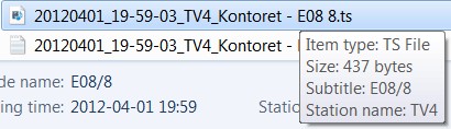

- The plugin uses the DVBVPropertyHandler.ini in the (DVBViewer) program folder to save it's configuration. Most value can't be changed or do have only effect on installation but there are two values which might be of interesst:
Wondering if it's perhaps possible to rename the fileinfo variables or is this hardcoded into the OS? For example the season and episode value in the fileinfo pop-up gets located under the "Subtitle" label/variable, which is quite confusing. It's of course the same for the explorer properties. The RS info files uses the "Info" label for the very same information, which is a bit less confusing.

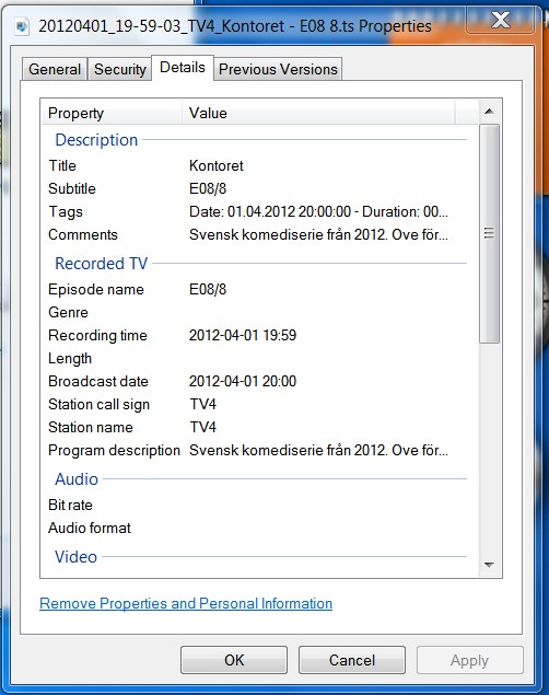

Big problems on my 64-bit system with DVBViewer Recording Properties v.2.0. All fileinfo/properties durations values has disappeard. The whole field is gone in the fileinfo and the recordings db has merely doubled in size. I have 652 .ts in the backup and 1147 is showing in rec.db. On my 32-bit system everything's normal with DVBViewer Recording Properties v.1.0.
Edited by majstang
Link to comment
That's intended. Before the duration was taken from the fileinfo, which was the epg duration. It did not take pre/post roll times into account. This caused severe trouble with the WMP, which took the wrong duration.
Now the correct fileduration is calculated among with the resolution and all. It is (for performance reason) deactivated for networked drives. You can activate it by setting in the file "DVBVPropertyHandler.ini" the entry
readnetwork=1
to 1. It might take some seconds until the setting gets active.

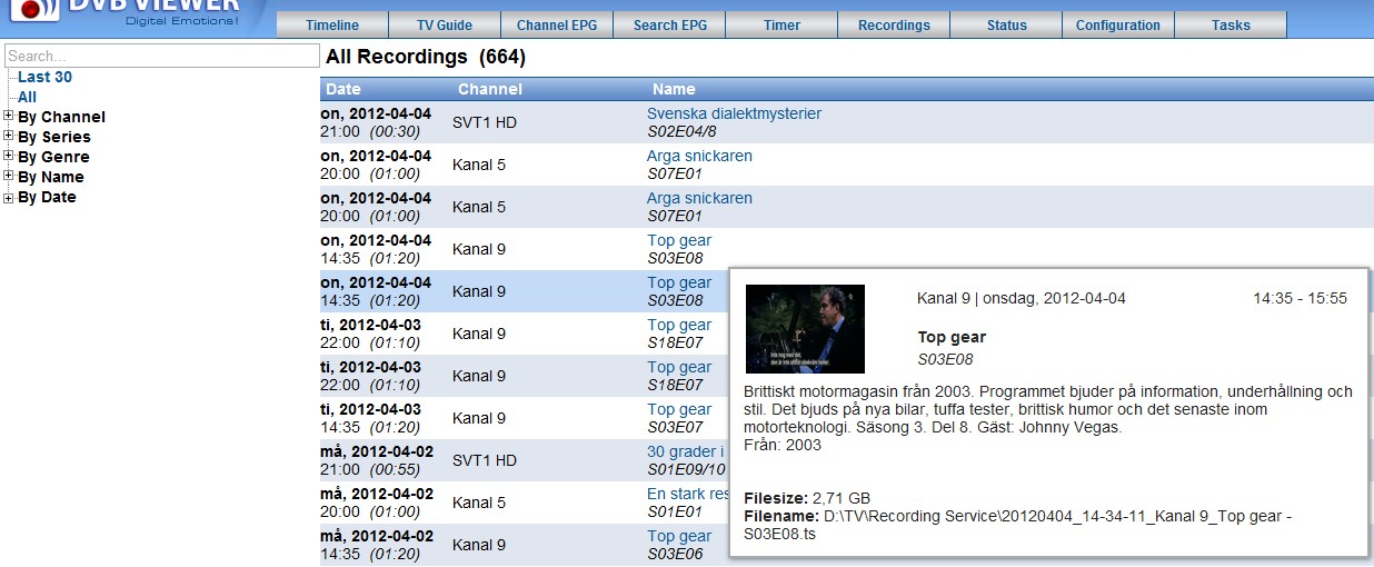

Just a minor detail. The thumbnail feature in v.2.0 doesn't generate a thumbnail in the tooltip for recordings (RS recordings tab) like the old thumbnailgenerator did. That was a nice feature so hopefully it will be back down the road :bye:
Link to comment
I've reworked the whole thumbnail generation quite a bit.
Now if available the LAV Filter Decoder and Source are used, because they are faster (-> hardware decoding) and keep the aspect ratio even if it changes within the offset. FFMpeg will only be a fallback then.
I'm currently working on minor details and hopefully the next beta will be out soon.
Edit:
After I read your post the second time: There never was a thumbnail in the tooltip? Where exactly do you mean?

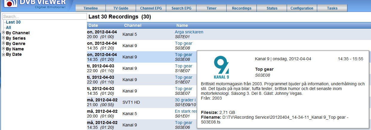

Yes, it is!
Checking the tooltip for an actual recording in my RS recordings database (webinterface-->Recordings tab) on my Win7 32-bit system with RS 1.9.4.1 and DVBViewer recording properties v.1.0 gives this:
Same recording with Win7 64-bit, RS 1.9.4.1 and DVBV Recording Properties 2.0 gives:
The thumbnail has been replaced by a channel logo.

Ah I see. Those are completely unrelated. The recording properties are only used for the Windows Explorer.
The Thumbnails for the recording service are created by the vthumbs.exe and ffmpeg (for now). Check your service.xml if it is activated
  <section name="Recording">
   <entry name="CreateThumbs">1</entry>

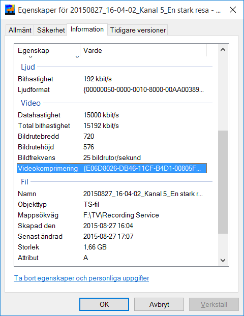

:( This beta doesn't work that well for Windows 10 x64. Particularly it uses the CLSID registry key for Audioformat/Video Compression instead of plain text. Also as said countless times it also sometimes fails to detect Audioformat and VideoCompression altogether, while MediaInfo.dll does not. Don't you think it's time for a better developed update to rid the bugs?
