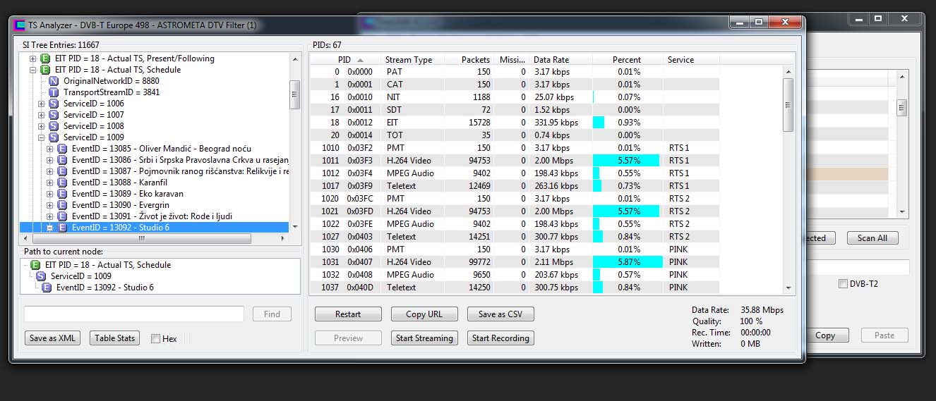

And I did try to scan via transedit 4.2.0
And in transedit I see epg in transedit in EIT PID.
