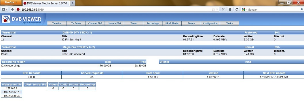

Mr. Man-wai Chang Posted June 16, 2012 Author Posted June 16, 2012 I am now running RS 1.9.7-beta. It really looked like it's a hardware error with the Magic-Pro ProHDTV 3. I re-plugged in the USB TV Tuner last week, and no problem had been encountered until now. Note that I did NOT enable the uPnP Media option. I am going to let the config run one more day (using both HDTV sticks to record shows simultaneously for 3.5 hours), and then I would post an apology and a case-closed notice.
Mr. Man-wai Chang Posted June 16, 2012 Author Posted June 16, 2012 (edited) Attaching a screenshot: Edited June 16, 2012 by Mr. Man-wai Chang
Mr. Man-wai Chang Posted June 17, 2012 Author Posted June 17, 2012 (edited) Another night passed and there was no problem with 1.9.7-beta. Apologize for filing a wrong complaint. It's really a USB connection issue. I don't wanna waste time going back to 1.9.6-beta. So I would like to close the case. Sorry! Edited June 17, 2012 by Mr. Man-wai Chang
